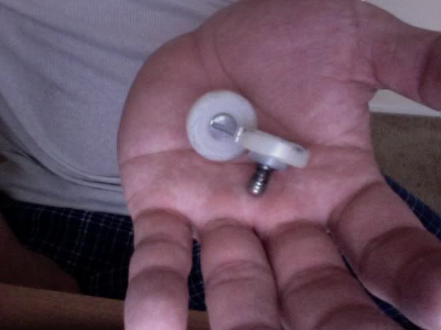

Just moved into a condo, couple issues with the stove. The front two burners can’t keep a temperature, they both turn off and on. Do I need to replace the burners or is it something else? Also, the drawer won’t close right and I found these.

The two pieces on the picture are the drawer support rollers. Looks like they are damaged and you need to order two new. The installation instructions included.
  • The drawer roller kit (two needed) AP2994446
