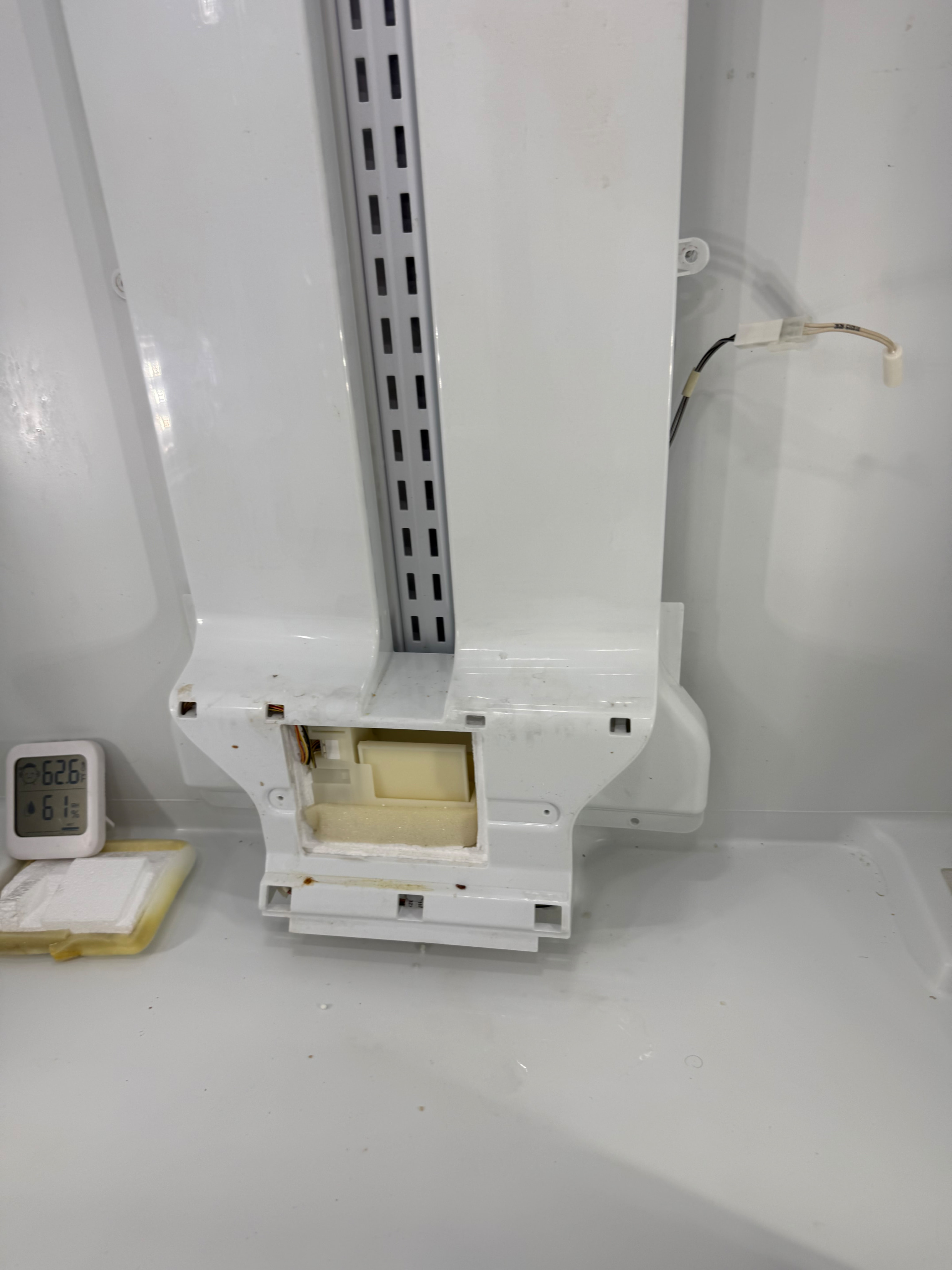

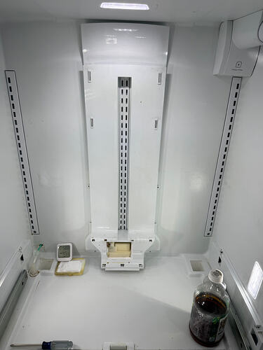

have a kenmore refrigerator 253.70413415 it started getting warm in the fresh compartment. Freezer works fine. It was high 40s low 50s. I noticed low airflow. No ice build up. I have replace the defrost thermostat and the door that allows air from the freezer with no improvement. The fan does run but no real air flow. Removed the rear air channel a found no blockage.

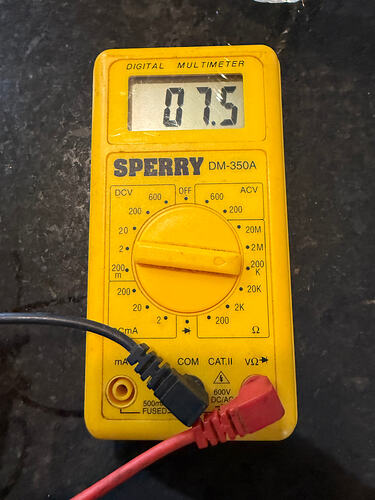

Checked the thermistor on ohms and it read 11.0 at room temp. In ice water it would read 19 but only for a second. Then went to no continuity. Checked it several times and would only read for a second. I need help.

When the air tower was removed to inspect air flow, was there any thing blocking the return vents to the sides? If you access the evaporator section, are the return vents clear of ice? Also, does the refrigerator run the fans and compressor continuously, or does it stop as if it thinks it has reached proper temperature?
I have it empty. No blockage. Couldn’t say if it runs all the time. Freezer is cold. Fan is not working now. Unsure why thermistor would only show 19 for a second at 32 degrees
Also no ice when I replaced the defrost thermostat.
What are the hole on either side of the floor?

I am still here. Did the thermistor show 19 Ohms or 19K Ohms? The holes on the sides are the return vents used to circulate the air back into the freezer.
Sure it was how I set the meter. I am not good with this thing. I know it supposed to be 11000 at room temp and it was but I had it set to 20k I think.
So I assume it was really reading 11.0 because I set it wrong. But it never got past 19.0 instead of the 26000 it should read. And it only lasted a second and repeat after removing a probe and checking again. Only for a second.
If you have a setting higher than 20K, it would need to be set to that. More than likely, the thermistor will get a higher reading. However, if the thermistor still reads only 19 when the meter is set past the 20K setting, it would indicate a thermistor failure as well as something else happening. Let me know what you find with the meter set on a higher setting and we can go from there.
First is temp at 70 degrees. The damper was open and internal temp at 62. Second temp is at ice water temp.
Is strange that the damper was open before I removed it. And I replaced the thermistor as soon as I took it out of the water. Also the fan isn’t working at all now.
And the damper opened as soon as I replaced the thermistor
