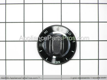

Hey Gene,
what do you mean by broken inside when you’re saying to take the knob off? Do you mean to take the whole front panel off and take the little box behind the oven knob apart? Or simply just take the knob off the front and look inside?
The knob seems to work, it just heats up way too much.
Thanks,
Jeff
Hi Jeff,
This is what we call “knob”:
If this part is not broken then the thermostat has to be replaced.
