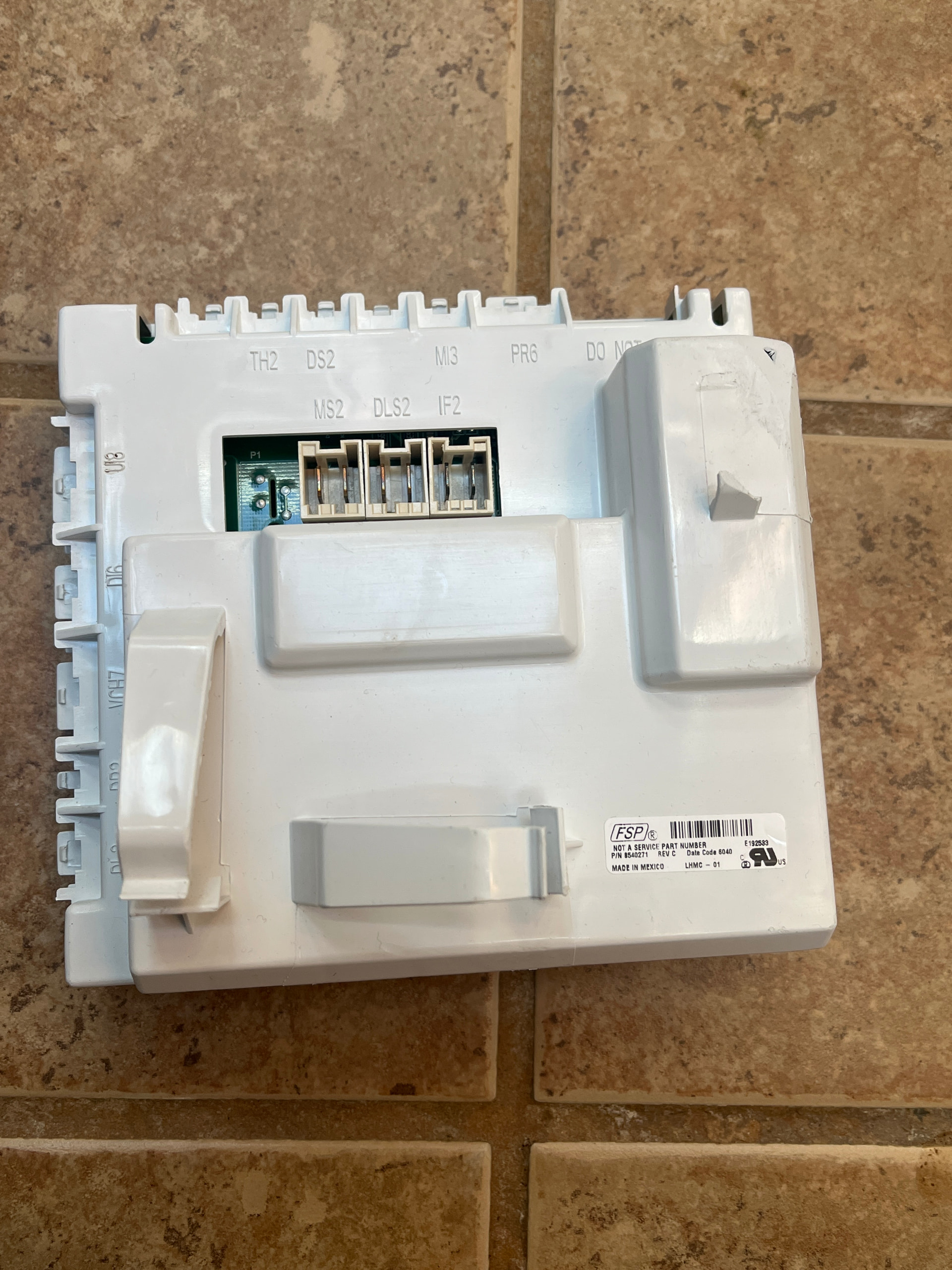

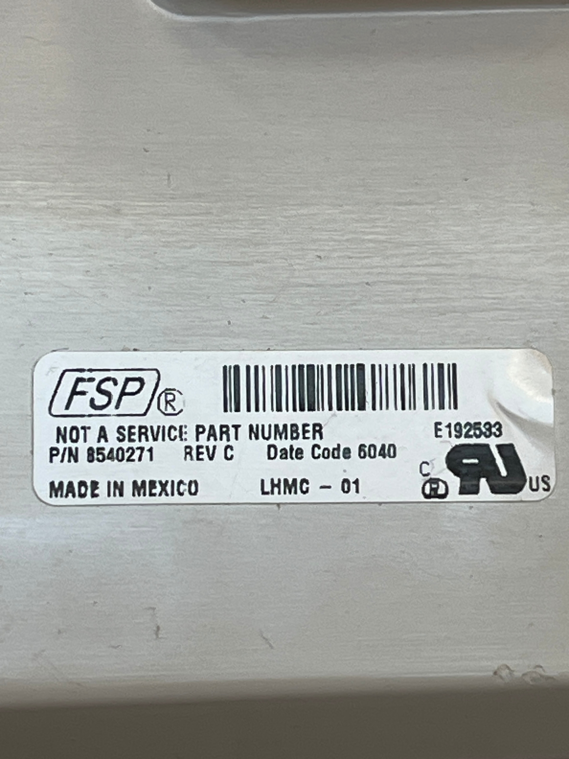

Brand: Kenmore
Model Number: 110.46462501
Main Symptom:Stops after 5 minutes of water filling
What happens & when: status lights Rinse, Clothes Clean lights illuminate F20 Code
Error Code (if any):F20
Parts or tests already tried:Diagnostic Test per manual
The machine on any cycle begins, and does its thing. Then water fills for 5 minutes than stops and throws the F20 Code with the Rinse and Clothes Clean light illuminated and all green lights flashing.
After running the diagnosis test per the manual it stops and throws the same code. I believe its the water level switch as “within 5 minutes the water level has not been reached by the switch sensing the machine stops”.
If I select the Rinse and spin cycle the machine functions as it should.
The question is: If the water level switch is bad, then why does the Rinse cycle function correctly? Shouldn’t the water level be messed up during the Rinse cycle as well?
I believe the Washer water level switch is faulty part number 8540224, superseded by WPW10163980, superseded by w11417619. However am I chasing the wrong thing?
