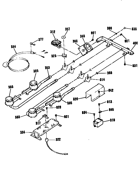

None of the burners on the stove top are working unless you use a match to light them…what part would I need to order to make these burners ignite when turned on?
The first thing I would do is check for 120 VAC at the power outlet where the cooktop power cord is plugged in. If there is nothing wrong then the spark module (#318 on the diagram) has to be replaced.
  • The part number for the spark module is AP2023163

Gene…what link do you mean when you say …To order the spark module just click on the link with the part number… I can handle tools very well…but how does this part get installed…the diagram that you sent me does not show where this part goes? redladys@aol.com

Here is the part number for the spark module AP2023163 which is linked to the order page. Just click on the part number.
In order to access this part you have to remove the knobs and the top panel. The spark module is located under the cover (#320 on the diagram).
