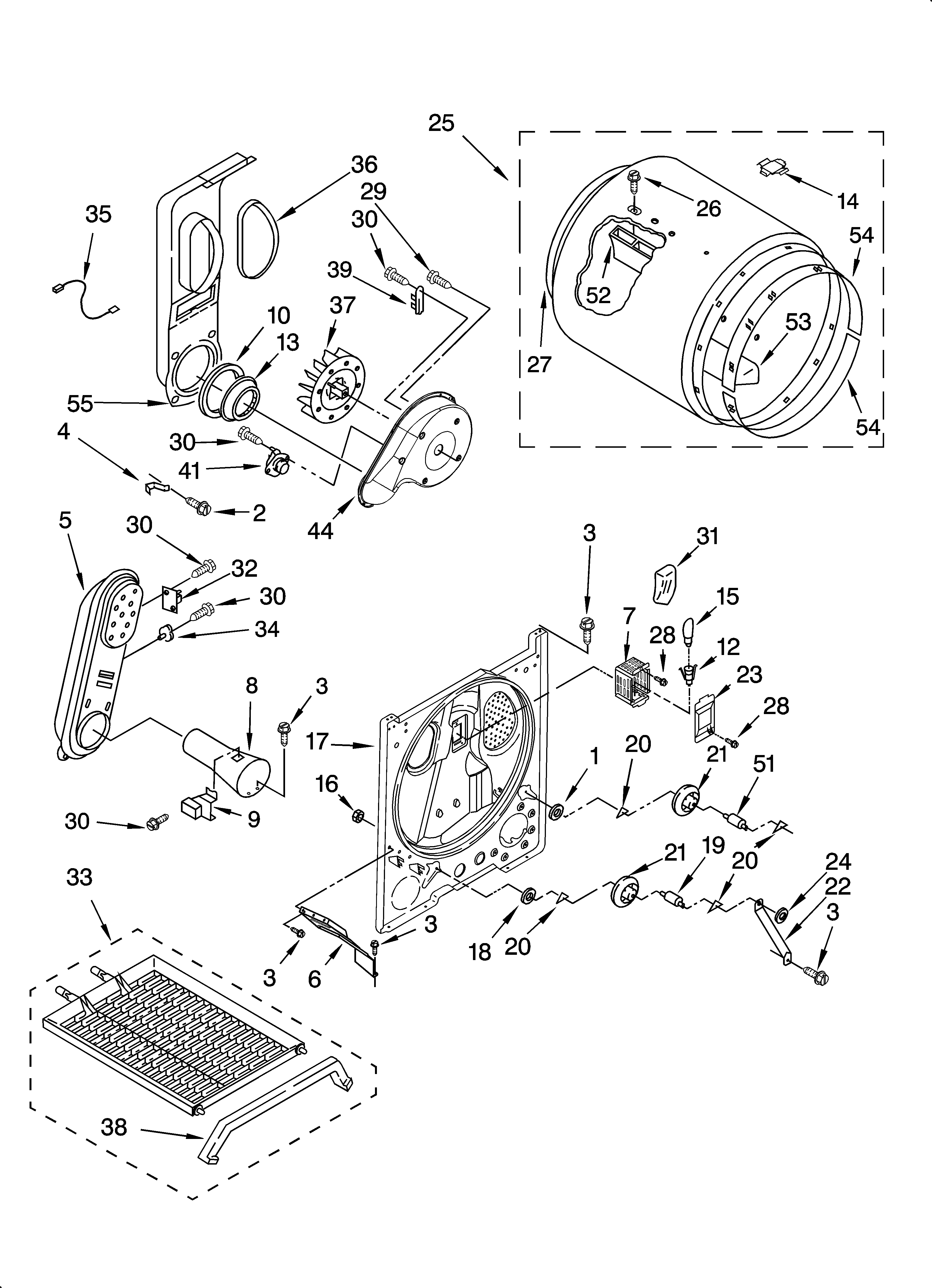

Very likely the dryer overheats due to an insufficient air flow. Have you removed the chute (#55 on the diagram) to clean it from lint and check the blower wheel?

Gene, #55 is the part where the exhaust vent connects to the back, right? If so I did clean a small amount of lint from there. Where is the blower wheel located?
Thanks!
If you click on the link in the previous post, you’ll see where it is.
