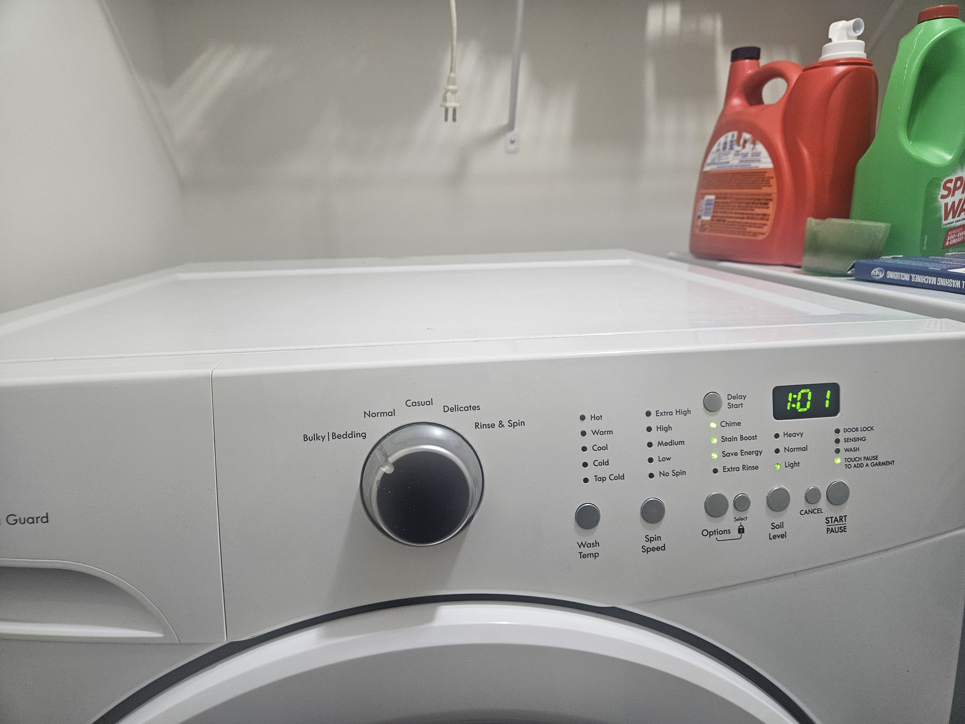

Kenmore Front Load Spin Cycles are Stripped
Brand: Kenmore
Model Number:417.41122310
Main Symptom: Certain cycles are stripped & unable to select wash temp or spin speed
What happens & when: When using the washer, can no longer use Bulky/Bedding and Normal cycles; they are stripped. I use casual cycle only.
Error Code (if any): Currently not receiving any error codes
Parts or tests already: Have not test or purchased any parts
Photos / video link: Casual cycle will allow wash temp and spin speed

I am still not sure what you mean by stripped. Are they just not working? Do you hear unusual noises when you try to run them? More details would help my diagnosis

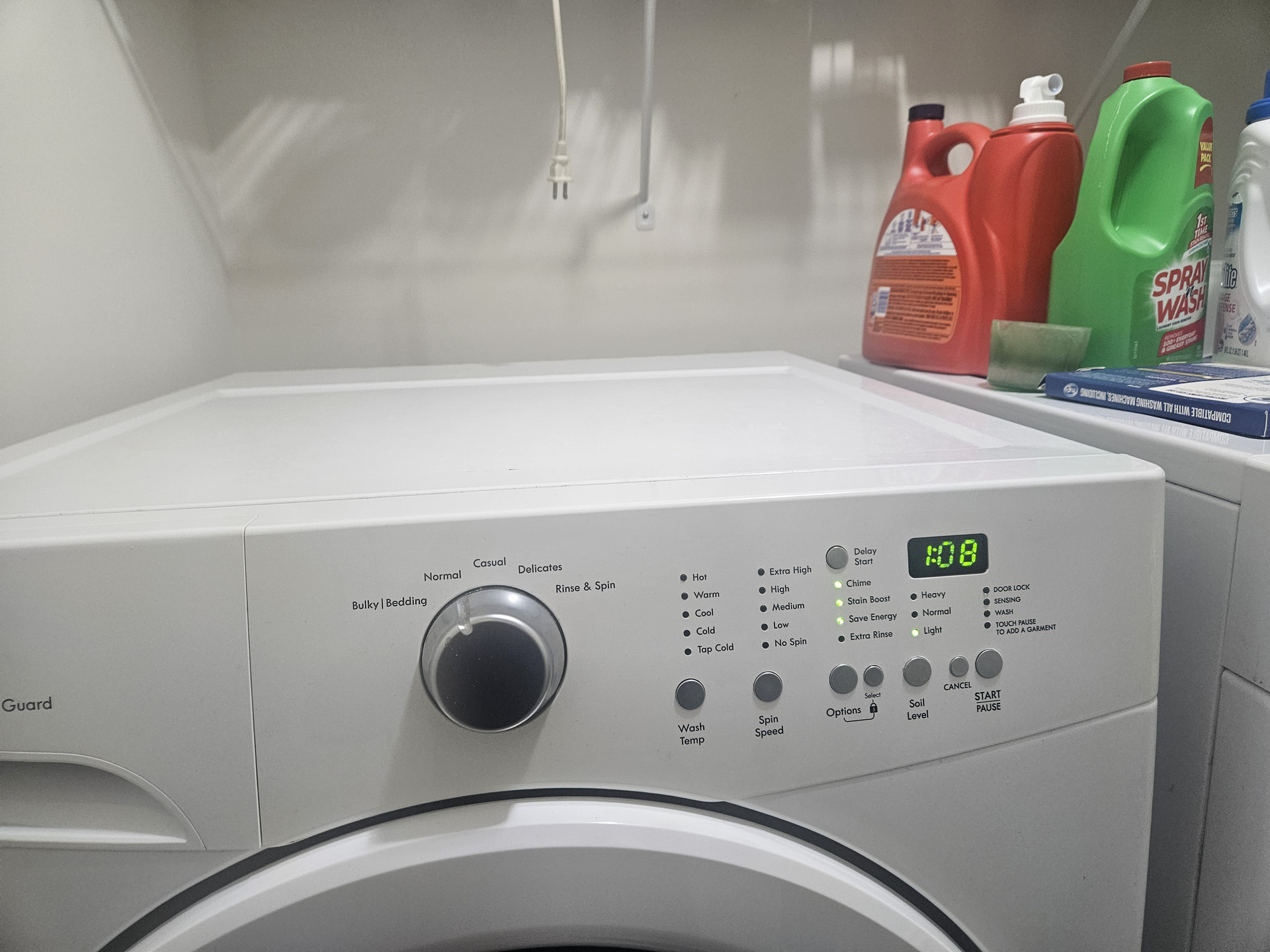

I’m not hearing a grinding sound. When you select the Bulky/Bedding and Normal cycles on the control panel, the wash temp and spin speed do not light up and you cannot select them. However, when I select the casual cycle, I can select the wash temp and spin speed.
I sent pictures of what each cycle looks like when selected. (Bulky/Bedding, Normal and Casual) The Casual cycle does show the lights for the wash temp and spin speed.
Also, the wash time for the Bulky/bedding and Normal cycles are incorrect. Bulky/Bedding cycle shows 1hour 1 min; Normal cycle shows 1 hour 8 min. Both cycles used to take approx. 50 min.
For Kenmore model 417.41122310, the symptom points to a problem with the control’s cycle configuration rather than a mechanical failure.

Most likely causes (in order)
  1. User Interface (UI) / Control Panel ( Frigidaire 809055507 Washer Electronic Control Board | Genuine OEM Part ) failure – Most common. Failed button matrix or UI board can prevent certain cycle selections and option changes.
  2. Main Electronic Control Board ( Frigidaire 137208014NH Washer Control Board | Genuine OEM Part ) – May have corrupted programming or an internal failure causing limited cycle availability.
  3. Control communication issue – Loose or damaged harness between the UI and main control.
Recommended troubleshooting
  1. Perform a power reset:
    • Unplug the washer for 5 minutes.
    • Restore power and check if the missing cycles return.
  2. Enter the washer’s diagnostic mode (if available) and check for stored error codes.
  3. Inspect the ribbon cable and wiring between the user interface and the main control.
  4. If no wiring issues are found:
    • Replace the User Interface/Console Assembly first.
    • If the issue remains, replace the Main Control Board.
Repair assessment
This is not consistent with a motor, drain, or sensor problem. Since only specific cycles and option selections are unavailable while the washer still operates on the Casual cycle, the failure is most likely in the electronic controls (UI or main control board).
