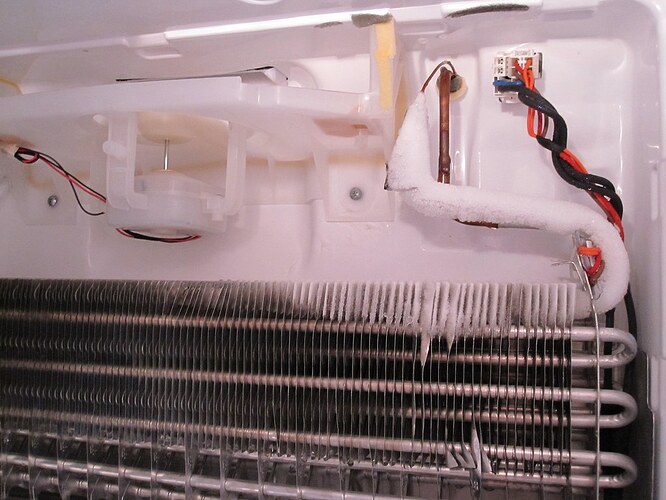

We have a Kenmore Elite 79577243601 bottom-freezer model made by LG. A few days ago, we started noticing that our freezer was not cold enough, as things were beginning to defrost/melt. The refrigerator temp seems to be OK, but I don’t have a thermometer to measure this. I have posted a photo of the evaporator coil in the back of the freezer; the spot where this comes into the freezer seems to be very frosted up.
Any suggestions are greatly appreciated! Thank you.
