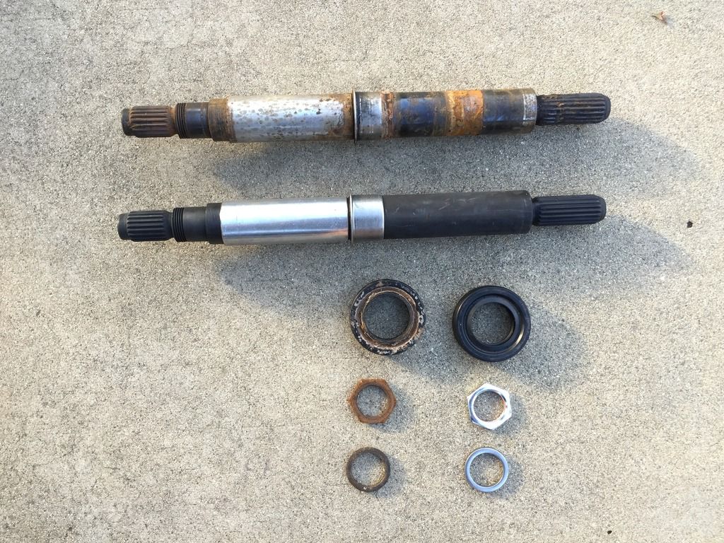

[LEFT][COLOR=#000000]I had the same problem getting the OL error and finally, after replacing several un-needed parts, found out how to fix it. So if your have the Kenmore Oasis or the Whirlpool Calypso, then read this before buying any parts.
OK, first off lets define what OL really stands for. Most people think it means “Over Load”, but it actually stands for “Outa Luck” because every time I would replace a part that was suppose to fix the problem I would still get the “Outa Luck” error. So after buying a new “wire harness & motor control” for $100 and a new “Electronic control” for $200, I finally dug in and started ripping the machine apart to figure it out.
What I found out is that there is a critical function I kept reading about but did not exactly know what it actually meant, and that is that the basket needs to “float”. Floating is when the tub fills up with water to a certain level the outter basket will rise about 1 inch from the center agitator. What this does is disengage the basket from the motor so that the agitator can rotate independently from the basket. If the basket does not float then when it trys to agitate the whole basket will turn back and forth at the same speed as the agitaor and this will cause the OL error code. The reason it gives the OL code is because if you pile too many clothes in the washer then it can keep the basket from floating properly.
I was getting the OL error even when there was only 2 small items in the washer, so it was not floating for some other reason besides being overloaded. You can check to see if the basket is floating freely by grabbing the inside top lip of the basket on both sides and pull up and if the basket raises about 1 inch then it is ok. But if it does not raise then you know there is a problem.
To fix the problem if the basket is not floating you will have to take the washer apart. Below are the steps to follow if you are mechanically able to tackle it,
  1. Unplug the power cord
  2. Lift the top of the washer up, to do this there are 2 latches in the seams between the top and the bottom sections. These latches are about 6 1/2 inches from the right side and left side of the washer. You need to insert a small screwdriver (be careful not to scratch the paint) and push the latch while lifting the top section.
  3. The top will actually fold back leaving the inner tube fully exposed. Support the glass lid so it doesn’t get damaged because it is very heavy and will fall open when you flip the top back.
  4. Remove the plastic top of the tub. There is one hose connected at the back and there are several snaps around the outter edge that hold it on. Remove the hose and unsnap the snaps and set it aside.
  5. Remove the cap covering the very center of the agitator. It is just snapped in place and can be pryed off with a small screwdriver.
  6. Remove the center screw under the cap.
  7. Remove the agitator, you need to lift it evenly and might have to work your way around by pulling on one of the three fins and then the next and so on. I also had luck using a small pair of needle nose pliers and grabing a small lip inside the area where the screw was and pulling from there.
  8. Remove the 6 phillips screws in the middle holding the plastic top gear in place. Be very careful you don’t drop one of the screws because it can fall through the slots in the basket and be lost below.
  9. Remove the plastic top gear.
  10. Pull the plastic lower gear off of the splined shaft. It should pull right off.
  11. Now you need to pull the basket up and off of the shaft. This is where you might have problems because the basket might be corroded to the shaft. If you can grab the basket on both sides under the outter lip and pull upward it might pull up. If not, then you will have to figure out a way to get it off.
  12. Once the basket is off you will notice there is liquid inside of it. That is factory sealed in there so do not worry about that, it is normal.
  13. With the basket is off you will be able to see that the shaft is probably corroded and the inside bearing on the basket is corroded. Clean these both off very good and check to see if the basket can easily go back on the shaft and slide up and down without getting stuck. I had to sand and file the shaft a little bit to get it totally cleaned up. The inned bearing of the basket is plastic so it is pretty easy to clean with light sanding.
  14. Reassemble in the reverse order and your done. Check to make sure the basket can easily float now by pulling up on it from the top inside lips.
I hope this saves some people a lot of aggrivation and money.

thanks for all the info…we checked the basket and it floats freely. Not sure that I want to take it all apart if that doesn’t seem to be the issue. Any other ideas as to what it maybe? Possbily one of the motor control or electronic control?
I am getting this error, and it does look like the floating tub was a bit corroded to the shaft, but the machine has been making more and more noise during the spin cycle, and now quits in the middle of it with the oL code, even with no clothes in. It looks like some grease is seeping in to the tub, and I noticed a spiral splatter underneath, so I suspect the seal and bearings are going. Can anyone tell me if this is a feasible repair, and what I will need to replace? I had to replace the control board a few months ago, so I’m wondering if it’s worth fixing, or time to move on.
Want to thank you immensely for your instructions for repairing the ol error code problem. To others with the same problem, follow these instructions word for word and save yourself a lot of many. Precise step by step and accurate expectations of problem. Thanks again!

“11. Now you need to pull the basket up and off of the shaft. This is where you might have problems because the basket might be corroded to the shaft. If you can grab the basket on both sides under the outter lip and pull upward it might pull up. If not, then you will have to figure out a way to get it off.”
On my washer the basket did not simply pull off as there was corrosion (rust) build up. With the basket hub removed I used a pipe wrench to grab the teeth of the drive shaft while rotating the basket and pulling up on the basket to free it from the drive shaft.

I’m currently have the same issues with my Kenmore Elite Oasis model # 110.27092603. I replaced the bearings, shaft, and seal on the tub. When I run through the diagnostic test the first error code that pops up is F70. The tub moves freely up and down so is there a way to clear that code?
As the diagnostic tests reaches C6 it spins the tub clockwise then counter clockwise and “oL” comes up. The tests were done with an empty tub.
Where do I begin to diagnose the issue without throwing random parts at it?
Thanks!
-B
P.S. I attached a photo of the NASTY shaft and bearings which were completely destroyed.
I had a hard time getting the basket out because it was corroded to the shaft so I put two of the six screws directly across from each other back in the threaded holes with a couple large flat washers and then used a gear puller to pull under the flat washers and it pried the basket up. Be careful that you don’t pry too hard because the screws are threaded into plastic. I didn’t have to pry very hard to get it to come off.
I actually had to pry off the top gear also with the same gear puller, again, be careful you don’t pry too hard because you can break the top gear.
Also, when I put it back together I applied a little Moly gear grease to the shaft and inside the basket bearing to keep it from corroding as fast. This is actually the second time I have done this procedure within 5 years and the first time I did not use the grease.
