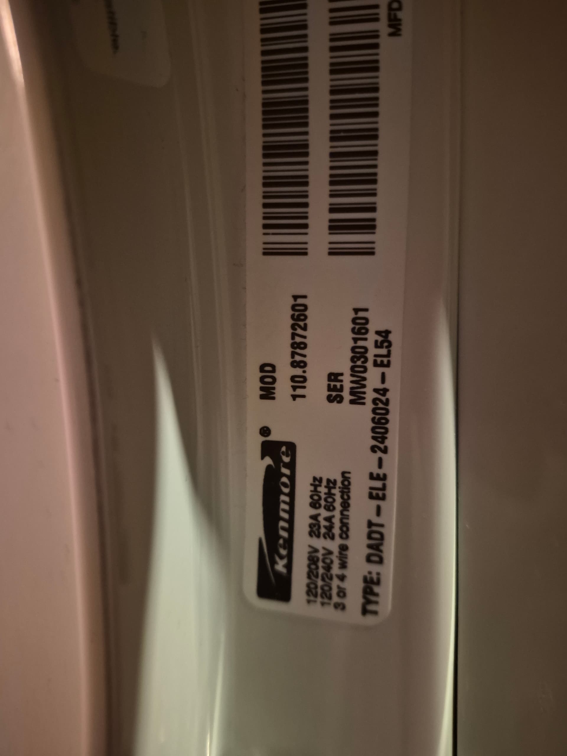

The model number that is listed is not showing as a good model and for us to be able to assist we would need the correct model number.
Please see attached a picture of the label on the door. Perhaps model 110.87872601 - what i provided was the TYPE.
Thank you.
