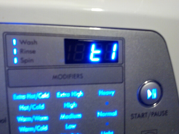

I have a Kenmore Elite Washer model 29272000 purchased in 2012. I turned it on and all LED’s are illuminated but not flashing. Any idea what is going on? Can this be reset?

Thanks. On the back of the machine it says “Model Number” followed only by ‘29272000’. The manual says “Model: 796.2927#”. It is a top loader. I was able to get it into diagnostic mode and there is a character I cannot create here: imagine and “E” with the top part missing and a ‘1’ next to it. (see attached). That will flash momentarily and then ‘39’ will flash, then back to the ‘E’ with the missing top part and it will repeat that.
The above codes are not in the diagnostic papers that are tucked in the machine.
If there is any additional information I can provide please let me know!

No I feel the control board is the problem based on the lack of codes, that is, that you are not getting a code that is usually generated. Since the diagnostics are embedded in the control board logic, when the control board fails it cannot diagnose itself and it generates gibberish which seems to be what you are getting.
