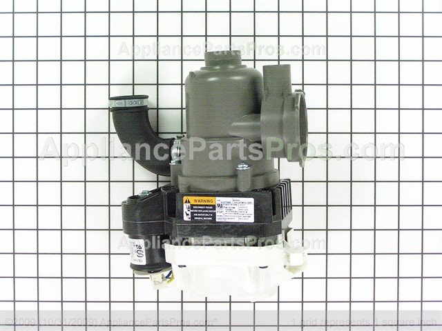

Once the water has stopped filling the wash motor and pump should start up to swish the water around. Power to the motor when it should be running but is not = new wash motor time. No power to the wash motor when it should be running is more of an circuit board or wiring issue.
LINK> Circulation Pump

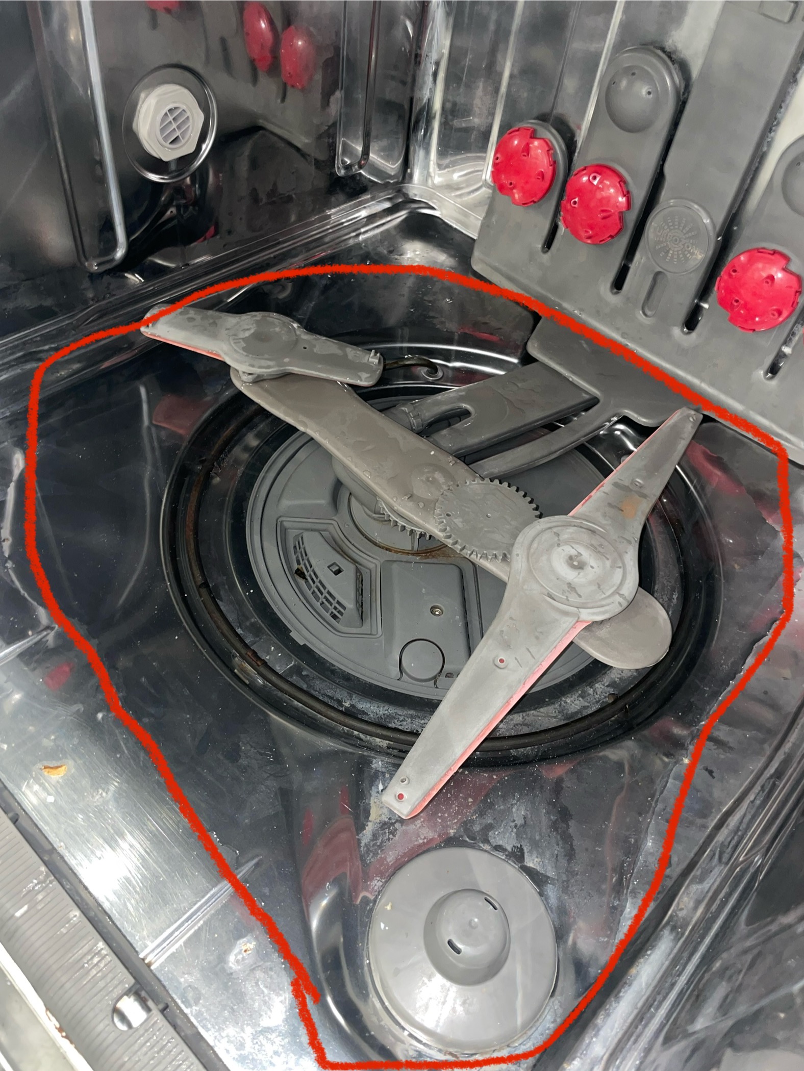

I appreciate the feedback. As more backstory, about 6 months ago it stopped filling, so I replaced the control board, and it started working. Not sure if that is relevant or not. Now it fills (picture below with outline of water line) but then doesn’t cycle and gives that error code. Is this filled enough? I can hear the float switch “click” with how high the water is right now, so I assume it is as full as it’s supposed to be?
Normally just under or just covering the heating element with the water is fine.

The heating element is covered, so it seems like it is getting enough water, the float stops it when it should, yet it still gives the f6e4 code, and doesn’t wash. Would it give that code if the circulation pump is broken? Could there still be something wrong with the inlet valve that causes it to fail even though it did what it was supposed to do?

Yes, element covered on your unit should be a good fill :slight_smile:

That is when power to the wash motor should be checked. No power there and we could have a board or wiring issue. Power there but the wash motor is not running should = new wash motor time.
jeff sr.
Turns out my issue was the circulation pump filter broke and so it was jamming the pump. Here’s a video I found on how to replace it.
