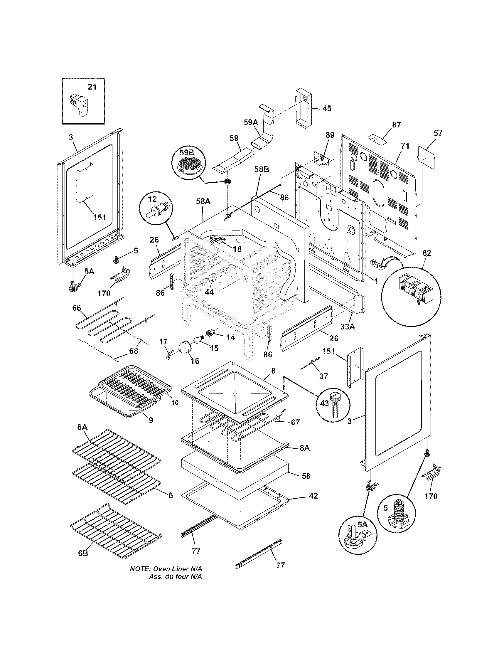

Self-Cleaning function will not work. when I press the “Select Clean” button on my stove and enter the amount of time I want it to clean, I get 3 quick beeps and self clean turns off and the current time of day reappears on the display screen. I followed all the instructions in my owner manual (pages 17 - 18). The stove is 2 years old. Any ideas?
The first thing I would do is check the latch motor assembly (#89 on the diagram) with the switches.
