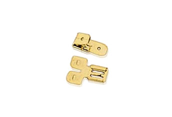

Element is getting way too hot. I’ve replaced the Thermostat, Cycling Thermostat, Thermal Limiter, Heating Element, Power Resistor & Wiring Harness (& lubed the drum bearing) in the dryer on this 2000 model combo unit (basically it’ll will run for another 15yrs if I can fig this out).
So I think it’s down to, a) Power resistor installed wrong (because updated part did not match previous equipment and using this solution (pic attached) was incorrect to connect blue wire/med setting & low settings on temp switch or, b) Temp select switch is bad.
Any input from a pro would be greatly appreciated. My girlfriend is really hating my diy attitude by now and the laundry is piling up.
Also attached are pics of old resistor & new
That resistor is only used during medium heat setting. Overheating problem is during medium heat, low heat or both?

The resistor ONLY LIMITS THE POWER OF THE HEATER so realisticy it cant over heat your dryer in NORMAL mode
i would check you snap disc thermastats again mabey one the hi limit got in the wrong spot

If you have a wire diagram id look to make sure when on low it is sending the power to the low t stat .. mabey your low switch is bad wrong or miss wired …
