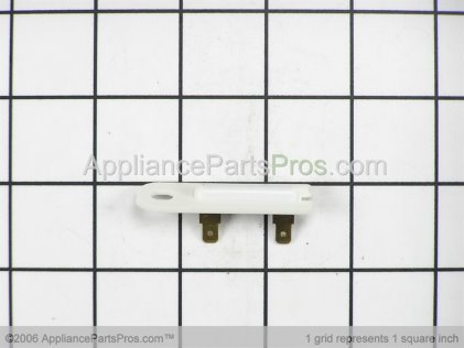

:confused: Hoping someone can help. My electric dryer recently stopped drying, it runs but doesn’t heat. I just changed the heating element, thermostat and cut off fuse at the same time and heating element came on. I thought it was fixed but stopped heating within 30 minutes?? Any idea on what else it could be, wiring seems in tact. Could it be the dryer thermostat??
model# 110.86873800 -kenmore electric dryer

The first thing I would check is the thermal fuse.
Check the thermal fuse for continuity and replace if it’s open.
[CENTER]The thermal fuse[/CENTER]
[CENTER] [/CENTER]
[LEFT]- The part number for the thermal fuse AP3132867 [/LEFT]
[LEFT]Also check the vent, the air ducts inside the dryer and the blower. Looks like the dryer was overheated.[/LEFT]
[LEFT]Gene.[/LEFT]
