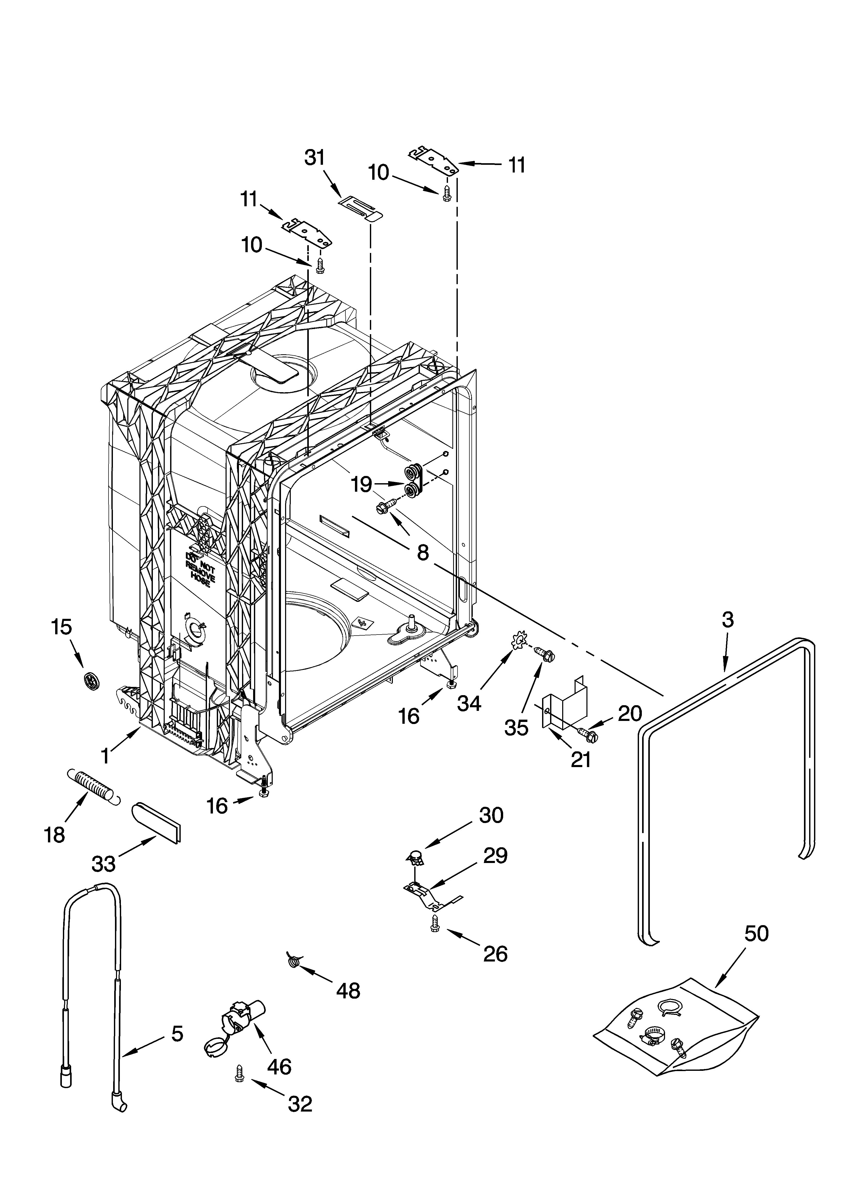

That means there are something wrong with the heating circuit.
There are three parts in this circuit: the high limit thermostat (#30 on the diagram), the heating element and the control board.
The high limit thermostat and the heating element have to be checked for continuity. If any of these parts is open, it has to be replaced. If there is nothing wrong with them, then the control board is the culprit.
The high limit thermostat [PART]AP3010530[/PART]
The heating element [PART]AP4325066[/PART]
The control board [PART]AP3775998[/PART]
