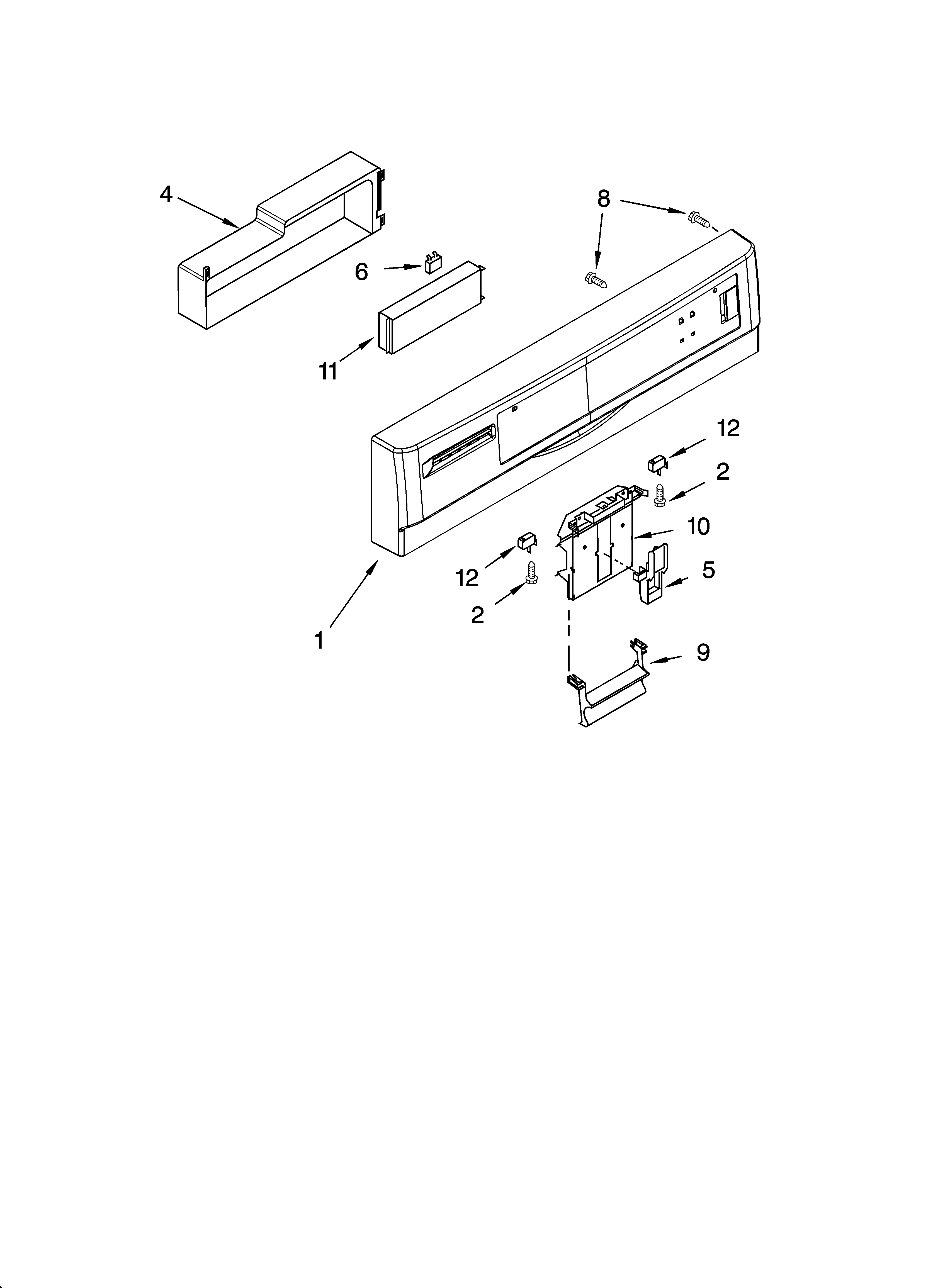

I think it’s either the micro computer board inside the door or the door control panel that is causing the problem, any way to narrow down which is at fault ?

The problem can be a bad thermal fuse (#6 on the diagram) which has to be tested for continuity.

Thanks Gene. I checked the thermal fuse and there is no continuity between the two terminals. I assume that means it’s bad and needs to be replaced, right?
