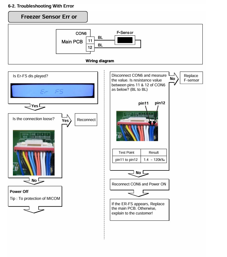

Please find attached all the info I could find
That does help, but it also adds a bit to the confusion…
I was finally able to unplug the Overload Protector Assembly from the Compressor and remove it to access the Overload Protector. (The plug is behind a metal bracket attached to the compressor, making it difficult to see.) The Overload Protector itself measures about 0.7 ohms cold, while the compressor winding measures 8.5 ohms, resulting in the 9.2 ohms that I had measured where it plugs into the chassis (since the two are in series). I assume that means that both the Overload Protector and the Compressor windings are normal.
But some details don’t match the materials. For example, there is no PTC starter in this unit, and the wiring harness only connects to two of the 3 pins on the compressor. The instructions for the Overload Protector appear to have a drawing of the PTC starter unit instead. The instructions for accessing the OLP/PTC cover are at best incomplete - the cover is too close to the sidewall, and the compressor is mounted differently.
The detail photo of the Lg EBG60663205 Refrigerator Compressor Overload Protector Assembly on your website is correct, however: it shows only two wires going to the compressor plug, and the Overload Protector but no PTC starter. But at this point, that doesn’t appear to be the problem.
Next step is to put it back together and try to measure the voltages at the control board.
There is no error code shown via the freezer and fridge temperature displays - they show the desired temperatures, even when the freezer was up to 35F and the fridge up to 55F.
I think I saw a reference somewhere to a push button on the controller board that forces the compressor to start. I may give that a try, too, once I get it put back together.
