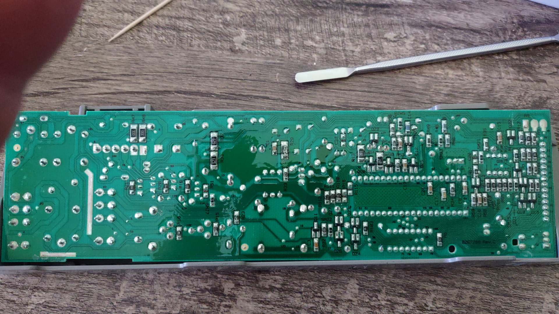

Does the main control have any indications of overheating on the back side?
No, neither the new board I installed nor the old board I took out show any indication of overheating.
This picture is of the back of the board I replaced, the board that was in the dishwasher when the control panel started acting up. There’s no evidence of overheating that I can see.
Power pins are to the left, ribbon connector is to the right.
With this, I do not see a reason the ribbon of the touchpad console would have failed aside from the touchpad console being faulty.
