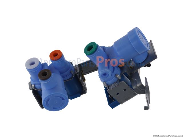

Kenmore 5220JB2009A water inlet valve
Brand:Kenmore
Model Number:79577563600
Main Symptom:no ice
What happens & when:wrong valve recommended
  1. is an (shudder) LG built Kenmore. I looked up:
Part #5221JB2006K replaces #5220JB2009A
LINK> Water Valve Assembly OEM Part
jeff sr.
That part has what looks like at least four water outlets. Mine only has one,my valve looks like part number MJX41178908. but that valve only has two wire connections. Mine has four.
That picture has one valve where the house water enters, that one should exit to the filter and then goes to the second valve where it is split up between the chilled water and ice maker.
Can you post a picture of your valve?
jeff sr.
I received and installed part number 5221JB2006K. The front half of valve is an exact match to 5220JB2009A. After installing, I turned on the water reset the refrigerator and 24 hours later still no ice,water dispenser is still working.
