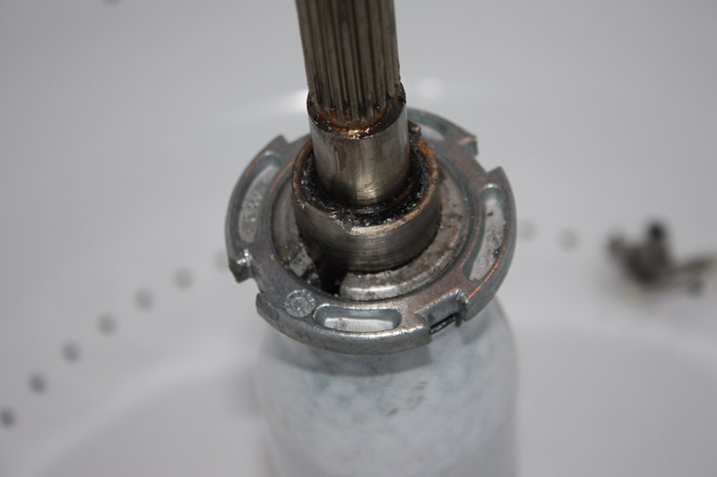

I have been having problems with the spin cycle not working with my Kenmore 500. Sometimes it will work, sometimes it won’t. I check the coupler, and it is okay, but didn’t want to get too far into the transmission and clutch, so I put it back together. I bypassed the lid switch to see if that was the problem, and the spin cycle worked while there was no clothing in the washer. So we put a load in, with the lid switch bypassed and ran the cycle. With clothes in the basket, the spin cycle won’t work.

So I removed the clutch and it seems to be in good condition. I don’t know how to tell exactly if it is good or not, but the pads still have thickness to them, the spring doesn’t seem abnormally weak, and the clutch lining seems to be in good shape. The only thing I can see is that the pads may be a little polished off.
Once I got to looking though, the two tabs that sit on top of the drive block, just above the special nut that holds the tub on, are quite bent and worn out. Plus there are metal shavings in the vicinity. Would this cause the spin cycle not to work?

Here is a pic of the top of the drive block. It seems like the drive block itself looks okay. My concern is the two tabs that are just above the spanner nut. They are rounded off and it seems like that is where the metal shavings are coming from.

[FONT=Times New Roman][SIZE=3][COLOR=#000000]Open the lid and bypass the lid switch by sticking something down to press the button. Put it is spin and watch it. If the shaft you see is turning but the tub is not then the drive block is bad. If that isn’t the case the problem is elsewhere. [/COLOR][/SIZE][/FONT]
Your drive block is broken and the top of the spin tube is damaged too.
Look closely at this pic of a drive block AP6008836
See how it has two slots and a lip that sets on top of the drive tube. Yours has broken and slid down the drive tube. That is why it won’t spin with a load. Also the basket is actually getting closer the the bottom of the tub and will soon rub on it.

Sears model numbers have a three digit prefix number. I used 110. on yours and came up with drive block AP6008836
I would try it with the old spin tube and see if it will hold. Just clean up any rough edges on the spin tube. I would probably clean it very well to remove any grease and maybe use a loctite kind of product to help the drive block lock onto the spin shaft. Tighten the nut pretty tight, just don’t get it too tight or you could damage the spin tube bearing. Good luck.

Thanks for all the help. I ended up just replacing the drive block. I should have taken a pic of the new and the old, but the inner ring of the drive block where the two notches are that hook in with the spin tube was completely gone. The two notches from the spin tube had shredded the inside ring of the drive block. Does anyone know what could cause that?
