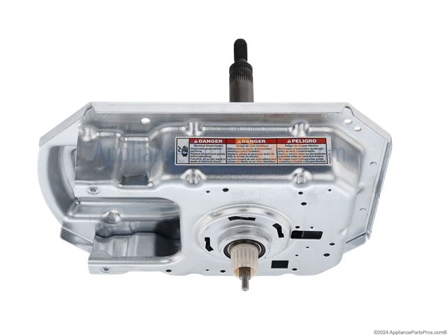

[quote=“Sc40, post:1, topic:408682”]
110.28002012)
[/quote]Based on the description and the model number supplied, you will need to replace the gearcase assembly. The gear case assembly houses the bearings, which is what is causing the noise. Link to the part:
