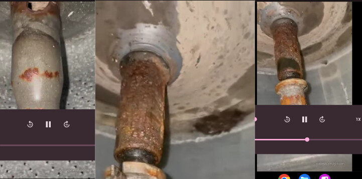

  2. NEW CLUTCH - No issues removing and replacing the clutch. Discovered when I removed the agitator that the
    center part of the inner tub is rusting out. There was actually a hole about the size of silver dollar or a ginger snap. I had
    seen periodically small broken pieces of rusted metal at the very bottom of a load of laundry under the agitator that I did
    not know where it was coming from. Still proceeded to complete clutch repair.

I plan to check the capacitor tomorrow with a little help. Today I am at a place of the inner tub
being fully stuck! I removed the clutch/transmission as I saw a post that said that may be an
easier way to get a stuck inner tub out, but so far it will not budge.
It sounds like the spin basket is stuck on the drive bock and the drive tube. I have had to use rope to try and provide upward pull on the spin basket while using a slightly long 2x2 piece of wood to hammer down on the drive block to get the basket to release.
