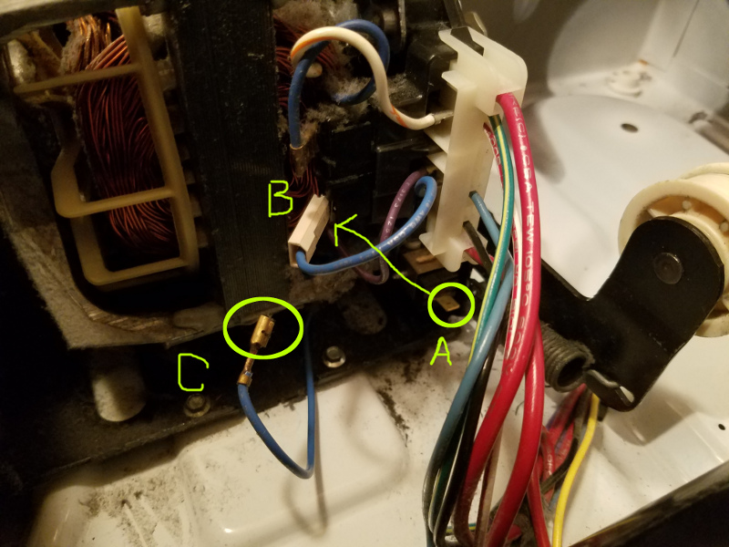

OK, I feel like an idiot.. I mistook a symptom for a cause. I tried to check the switch for continuity but I could not reach both sides. But I notice, which I missed before, that I did not get a short when I have the dryer apart and was testing it. The answer why was simple upon additional thought. The belt switch WAS working and when the tension was off, the switch disconnected the power line and thus masked the down steam short cause. So, I jumpered around the switch, and the short came back. Now it seems I am at the motor. I have attached a photo of where I jumpered around the switch by unplugging one wire and moving another. Now that the short is back, I decided to free spin the motor, when I do the resistance changes and fluctuates between about 2.0 and 2.6 ohms (which seems not good).
My jumper (see attached photo) consists of removing the wire C from position B, (leaving it hanging) and them removing wire from position A and moving and attaching to position B.
The black block attached to the motor, is it a starter relay of some type that can be replace or is it part of the motor? I am thinking at this point, my motor is bad? I have already replaced the a lot of the down stream parts.

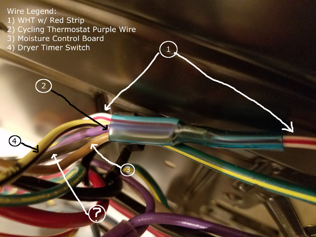

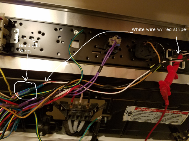

Since you were gracious enough to answer my questions, I will explain what I did to find the short (least I can do and I like closure.. :wink: ) My previous post explains all of the troubleshooting that I did with the exception of replacing the cycling thermostat (which went in uneventfully.)
The first picture I am showing (overall.jpg) shows the white wire with the red stripe in its path across the back to the multi-wire splice intersection.
The second picture (cluster.jpg) shows where I traced the various wires too.. Full disclosure, I did this about 3 days ago and I am colorblind so it is POSSIBLE I didn’t get everything labelled correctly, but rest assured wires from that bundle DID go to the various locations listed. The question mark shown was one that I just completely forgot where it went.
After I got the Cycling thermostat out, I shook it and the inside was rattling. I am assuming something on the inside broke loose and was ground to the outside case.
