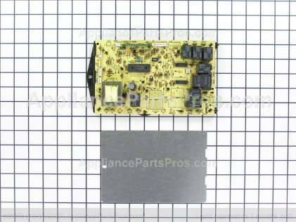

Im having an f5 code on jenn air model sve47600b was wondering if this could come from the relay board #28 in body break down diagram. Pulled back off unit this board was barely hanging on and has a burnt look to it. Oven not working but fan and top are. Thanks Daniel
The cause of the “F5” error code could be an intermittent contact on the power relay board or an intermittent oven temperature sensor (or it’s wire harness).
A burned spot on the power relay board makes this part a very first failure suspect.
The part reference #28 is not the oven power relay board. It is the downdraft power relay board. The oven power relay board has the reference # 29 on the body break down diagram.
Make sure this is the part with a burned spot on it.

I had the same problem had a slight hum/buzz coming from oven removed control board and check the componts noticed some resdue arount the 47mf cap in the middle of board so i replaced this cap and it works now

I had an intermittent F5 error and checked the temp probe which was fine.
I also fixed my oven by replacing the 47uF Cap on the Relay Board. Of course this was after I replaced the Control Board ($250), which was fine.
Just be careful while de soldering the old capacitor. The traces on the PC board come up very easily.
