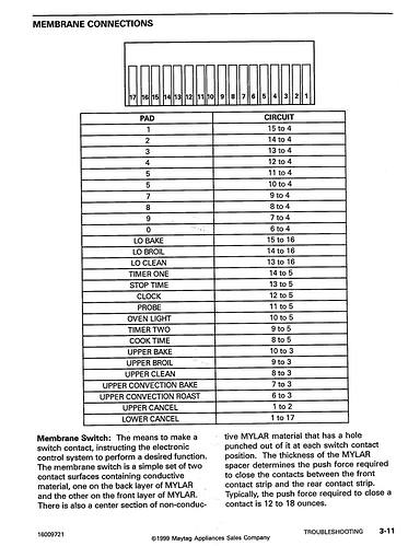

Manual says F7 is either the membrane or the control board.
You have the control board available (according to your website) but not the membrane (not available anymore)
How can I determine which one it is before I order a board.
Any testing?
You can test the membrane switch connections using the chart below and a multimeter set for continuity. I’d start by using the Upper Cancel button to determine which end is # 1 since they don’t have a better reference to go by other than that. Press on the button or pad in question to make the circuit you’re trying to read for continuity.
