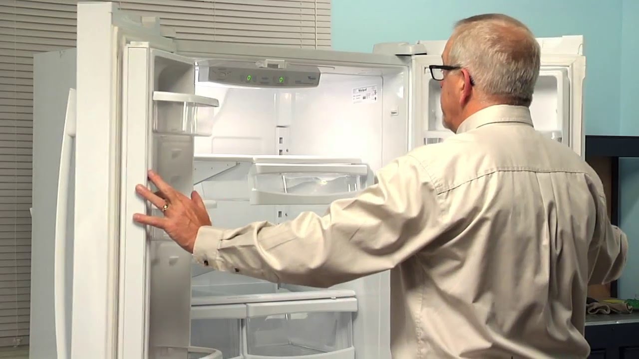

Actually, I ordered that part below from this website and it doesn’t look quite right. Can anybody comment on whether that is the correct part? I expected something similar to this:
Although I can’t open up the fridge easily and look as I don’t have access to it.
Anybody got any tips on this?
https://www.jennairreplacementparts.com/PartDetail/Dispenser-Control-Board/4459609
The tech said to replace the dispenser control board, but why would that stop the fridge and freezer from cooling? The dispenser did stop working, but so did the entire fridge. It made sense if the main control board was the problem, but not the dispenser control board. Is that a common Jenn Air problem?
