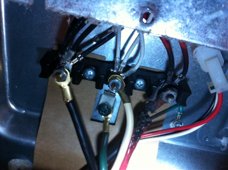

Hey thanks for the reply. I just pulled the stove out and noticed that the red wire looks like it melted/caught fire.
I’ve included a picture here.
I’m perplexed how this happened and what I can do to prevent it in the future.
photo (2).jpg (65.6 KB)
Could be that there was a poor connection at this point on the terminal strip from day one. As current passes through a bad connection it produces heat, this degrades the connection so more heat and so on and so on till the connection fails.
Remove the wires from the connection and check them and the terminal strip.
You may need a new terminal strip.
All connectors must be cleaned up with fine emery cloth or a file.
I would not try putting a new connector on the line cord unless you have some experience. It can be difficult to get it crimped on correctly.
Also the wire has to be cut back till you get to nice clean copper.
You could replace the line cord or strip it and attach the wire directly to the terminal strip. Be sure to put a washer under the nut and over the wire so that when you tighten it up the wire does not twist.
Another possibility is to use a set screw type wire connector and connect the 3 wires directly together. Be sure it is the high temperature type (hard plastic/bakelite shell (see below). They are available at any hardware or electrical supply store.

I also use antioxidant grease on the connections. In my neck of the woods it is used on all high current connections even though it was originally designed for aluminum wire. Just do not go crazy with it as it does conduct electricity.
