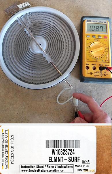

I was a technician repairing range and other equipment in my other life. I also own a Jenn Air range and I got the same problem. Most of the time the problem comes from the “Epic Sensor”, this sensor is a protection against an overheating of the element that could damage the ceramic cooktop. Only the most powerful element have that. The sensor can’t be bought apart so we have to replace the complete element for 200$. Not cheap at all. My range have 7 years and I replaced the element two times, which include the epic sensor.
This sensor is a thermistance, when the element temperature increase its resistance increase if its too hot it act on the infinite switch and cut the voltage. This is the tic toc sound that we hear from the infinite switch, and it can mislead the technician to a replacement of the infinite switch rather than the element.
Testing the element epic sensor is not so hard…
1: Disconnect the harness. It’s the 2 wire harness.
2: Use a multimeter and measure the sensor resistance it should be close to 1087 Ohm.
3: If you heat the sensor by some means it’s resistance should increase.
What can complicate the analysis is that the infinite switch could also be the problem. This week I changed the element and switch at the same time for 300$, not cheap at all. And believe it or not, the tic toc appeared. It disappeared when I changed the setting.
