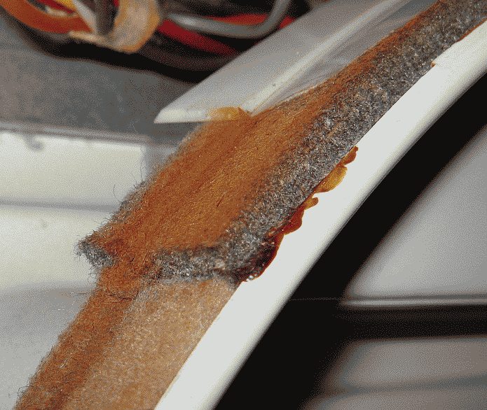

I have a minor mystery regarding the wear pattern on the two ends of the lower seal. [COLOR=Red]I’ve attached a close-up photo that shows where one end of the thin lower seal abuts one end of the thicker upper seal.[/COLOR] The upper & lower seals and the nylon glides show wear on the portions deepest into the lip of the front of the drum, but they’re as thick as when new on the portions closest to a person standing in front of the dryer. Most of this wear pattern makes sense; it means the seals and glides don’t mate deeply into the drum when the front panel is attached to the dryer. What doesn’t make sense to me is the wear at the two ends of the lower seal. The ends of the lower seal abut the ends of the much thicker upper seal. Due to the different thicknesses, I don’t see how the rotating drum can touch the ends of the lower seal, yet the ends of the lower seal have the same wear pattern as the rest of the lower seal: worn on the portion deepest into the drum. How did the drum rub against the thin seal where the thick seal was right next to it?
(The photo also shows where a corner of one of the nylon glides has broken off. This is the trailing glide while the motor is spinning forward, so it seems a bit counter-intuitive to me that the corner broke from this glide instead of from the glide that leads when the motor spins forward.)

Not sure I understand the quetion. The glide do look worn badly,
It looks like the glide is diferent than what is shown in the parts re: the glide itself does not cover the felt backing width but this may be just due to wear,
Perhaps the following video will help you.
A different model machind but the glides look the same.

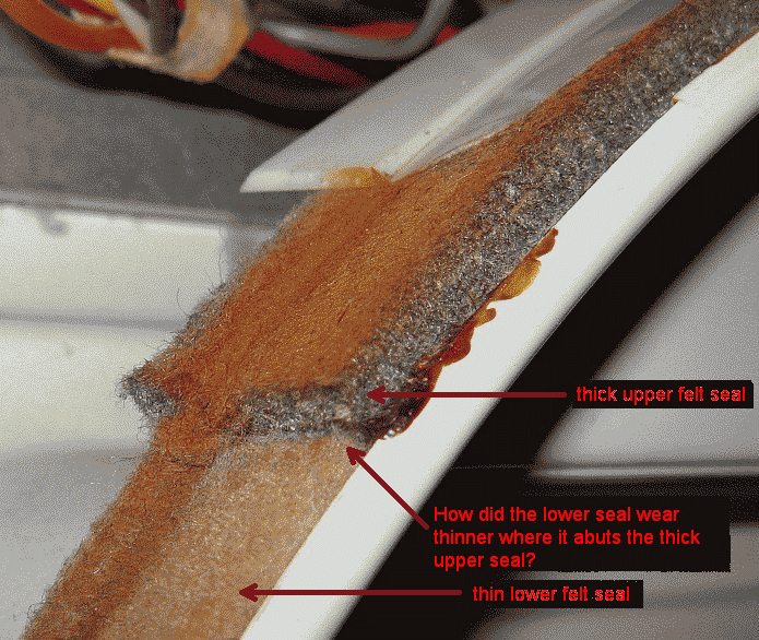

Regarding the “mystery” of the wear pattern that I asked about in my previous message, I’m attaching another photo to try to make the question clearer. It’s the same image as in the previous message, but marked up with some annotations. And here’s a rephrasing of the question: Where the end of the lower seal abuts the end of the upper seal, I would presume the drum contacts only the upper seal because it’s so much thicker than the lower seal. So if the drum never contacts the lower seal there, why did the lower seal wear there?
Regarding the nylon glide’s wear and position on the upper seal, the photo is deceptive. A top view would show the glide actually does reach to within about a millimeter of the edge of the felt, like in the AppliancePartsPro product image. The angled view is deceptive because the brown stain penetrates far enough into the felt that some of the side of the felt looks as if it’s part of the top of the felt.
What is that brown stain, by the way? I don’t see rust anywhere in the dryer, and the lip of the drum that contacts the seals is black, not brown. Is the brown color a sign of a problem? Is it a clue about the overheating? Is it a clue about whether the seals leak?
I don’t know why the nylon glides are manufactured so wide that one of their edges sticks out about half an inch beyond the felt (in the direction away from the drum). (They’re the same in the AppliancePartsPro image too.) I don’t see a purpose for the glides to be so wide. They don’t wear there, which means they don’t bear any of the drum’s weight nor reduce the friction. Also, the underside view in the AppliancePartsPro image shows the pair of nylon studs that descend from each glide into the felt (which help hold the glide in position on the felt) are located far from the edge that sticks out, which means the edge doesn’t provide structural strength to the studs.

The brown residue looks like glue that has discolored over time.
In the photo I attached to my previous post, there are two brown colors. I was asking about the brown stain on the surface of the seals, not the little globs of brown glue near where the lower seal abuts the upper seal. The upper seal was originally gray and the lower seal was originally white. When you say the brown is glue residue, are you saying glue migrated out from underneath the seals and coated the surfaces of the seals, or are you referring only to the little brown globs?
