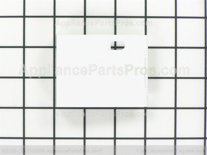

I did break the swing door on the inside left of the fridge that closes when the freezer door is closed, if you could help me with the part # that I can order. Thanks again.
Good job!
The part number for the flipper is AP3037562
[CENTER]The flipper
[/CENTER]
[LEFT]Gene.[/LEFT]
