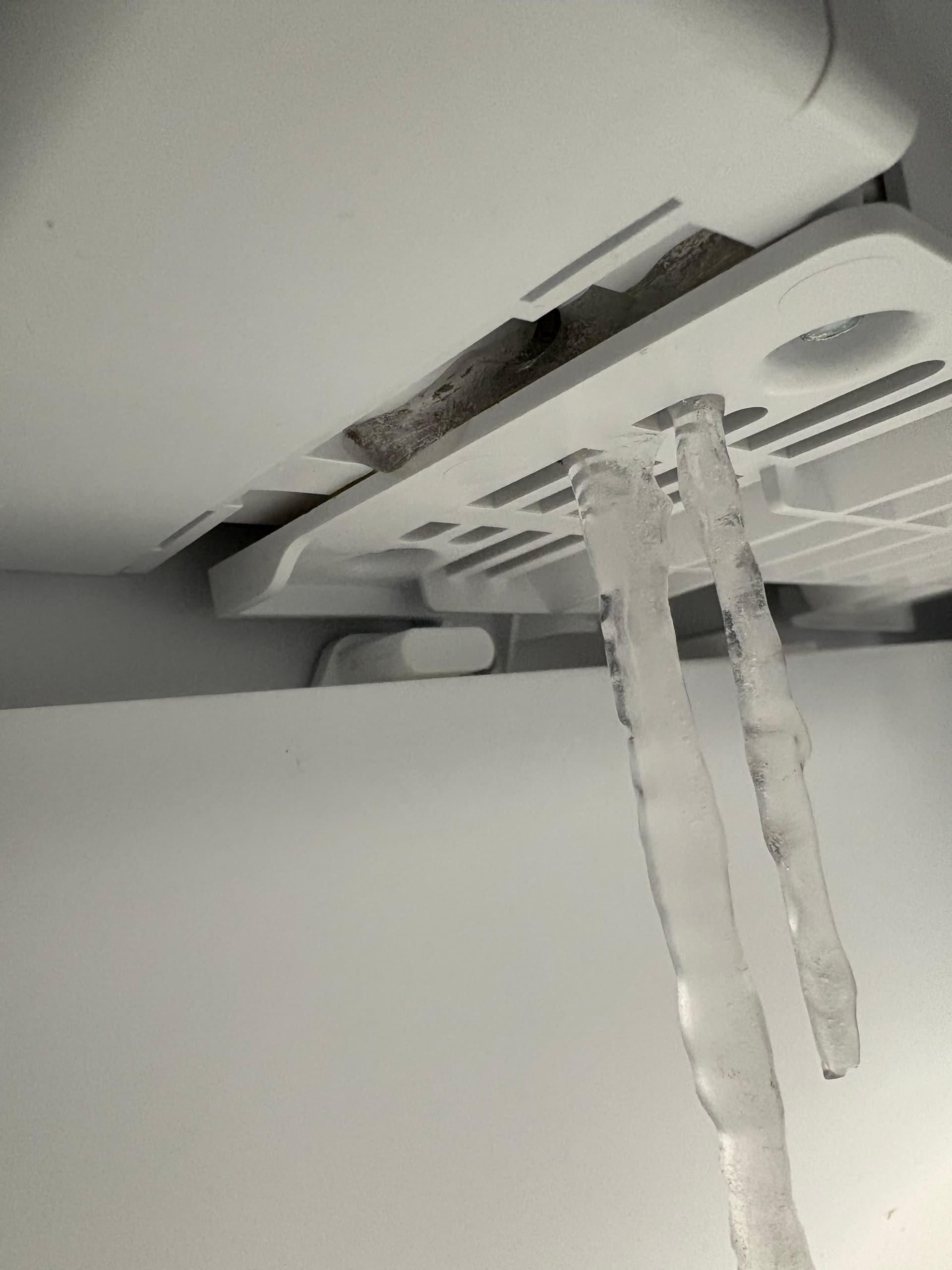

Ice maker leaking water
Brand: whirlpool
Model Number: wrs325fdam02
Main Symptom: ice maker leaking water, ice is still being made
What happens & when: when ice maker is filling
Error Code (if any): none
Parts or tests already tried: NA
Is the water leaking down the ice maker into the ice bin from the ice maker overfilling?

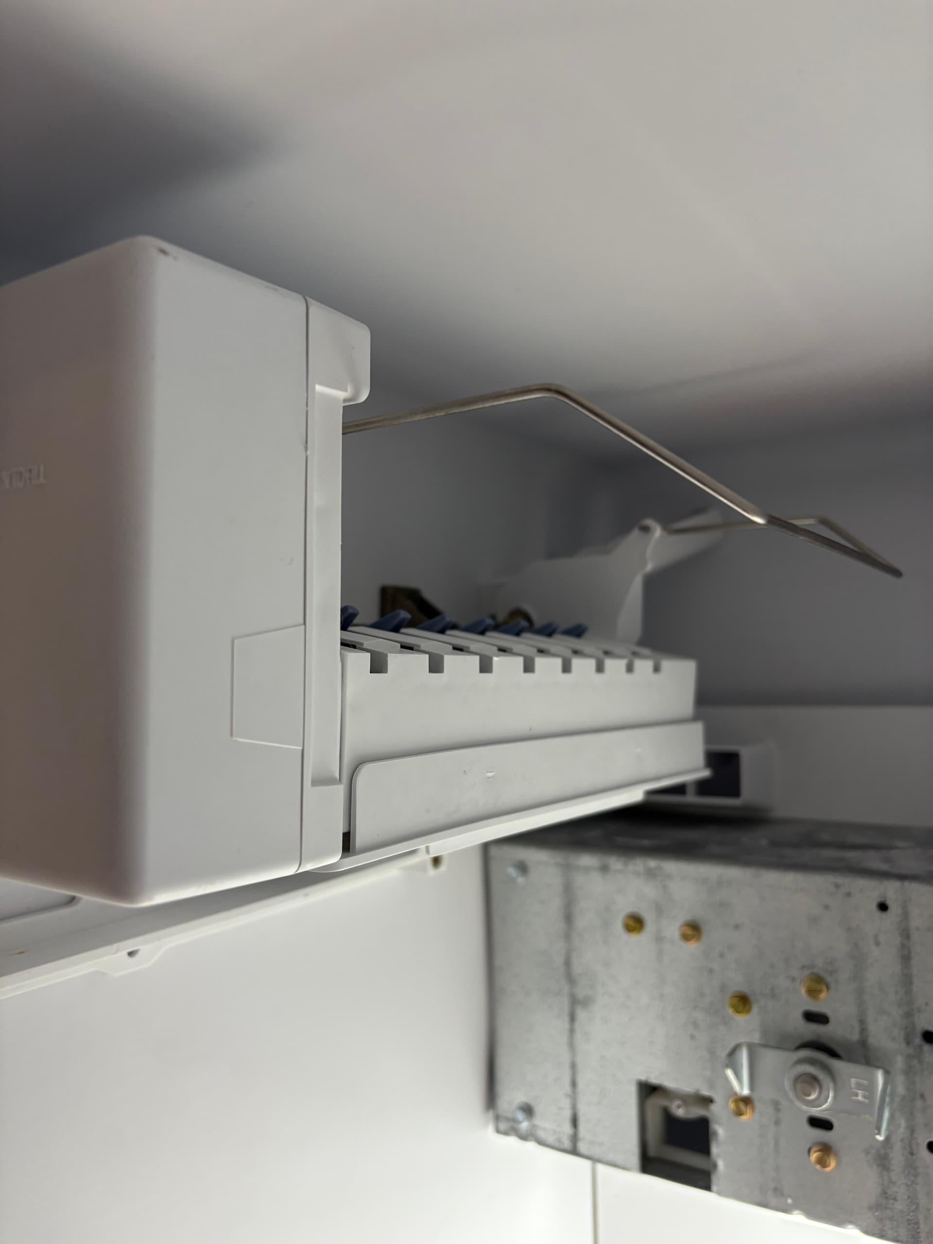

I do not think it is overflowing but I am not sure. I have attached some photos.
It looks like the ice maker has a failure in the ice tray and replacing the ice maker should fix the issue. WPW10300022 Icemaker | Genuine Whirlpool OEM In Stock
Thank You. Just ordered it!
