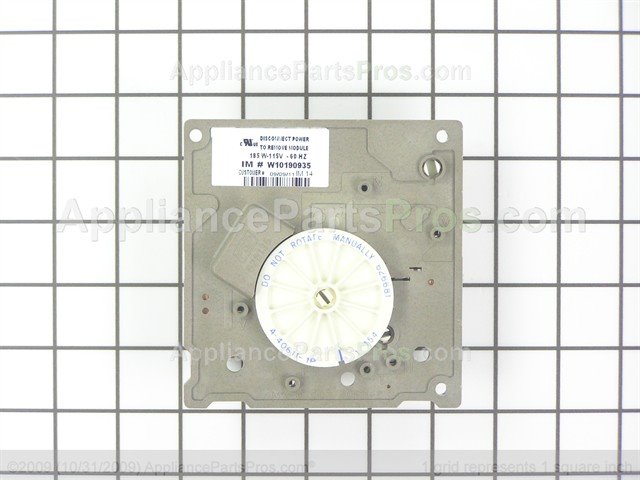

Does the front end of your ice maker look like this?
If it does the only way it could get that hot are if somebody left a jumper wire in between T and H on the front or if the thermostat was stuck “on” inside the gear head.
I’m pretty sure they also have a thermal fuse on the ice mold that should stop any overheating.
I can’t see anything that looks like the picture you posted. However, having replaced the ice maker once before, I know that replacement part is Supco RIM597.
Also, no repair work was done before this problem started so there’s no way it could be the jumper. The ice maker has been working fine since I replaced it a couple of years ago. Only issue is that cubes sometimes get stuck in the fingers preventing anything from happening until cleared.

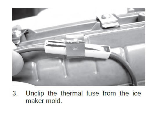

Have you checked the inline thermal fuse that clips onto the ice maker?
I have not checked the thermal fuse. Since it’s part of the new ice maker unit I just installed, would that indicate the unit itself is defective? I assume I would check for continuity but I don’t see any test points. How do I test?
