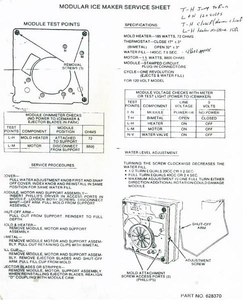

If your feeling BRAVE!!!LOL!!! Its most likely the THERMOSTAT in the icemaker, Its not bad to change,once you find it!!!:smiley:
Here some help with troubleshooting
