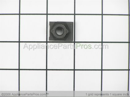

I just purchased the above motor for the GE Refrig ice auger dispenser. I removed the old one but cannot remove the forked prong that the auger slides into. There is a nut with a special washer/clip to keep the nut from turning or coming loose. I believe it is a left handed thread, but I do not know how to remove the washer/clip to remove the forked prong. Any Ideas? Thanks

The nut you are talking about is a “J” nut or a permanently mounted speednut clip.
[CENTER] [/CENTER]
[LEFT]If you can not remove it then break it off and put a new one.[/LEFT]
[LEFT]- The part number for the speednut is AP2642658 [/LEFT]
[LEFT]Gene.[/LEFT]
Gene, thanks for the reply. I just wasn’t sure if I needed to break off the clip and then remove the nut. Then replace the clip upon replacing the motor. Or is it one part? I see the two sides of the nut that are pounded down to keep the clip on, should I file them off and bend the clip off? Then remove the nut? Or is this something that definately needs to be replaced and I should order spares before I attempt to replace the auger motor? Thanks again, your help is greatly appreciated…Bob

To be honest I never replaced this motor myself and my recommendations based on what I can see on the diagrams and the pictures.
Try to remove this clip to unlock the nut and I believe you can file it off.
Click on the picture in the previous post to enlarge it and you’ll see this nut from both sides.
Good luck.
