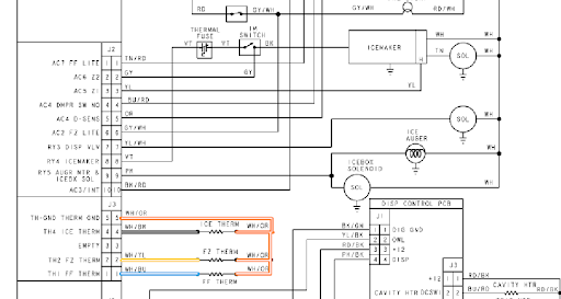

Ice compartment fan stops when ice maker is switched on
Brand:whirlpool
**Model Number:**Gi5fsaxvy02
Main Symptom: ice maker doesn’t work and refrigerator gets warm
What happens & when: fan stops blowing into ice compartment and refrigerator section when the ice maker is switched on
Parts or tests already tried: replaced high voltage control board

I am not sure that you understand but the ice maker is in the refrigerator section, in the upper left corner. There is a fan that pulls cold air up from the freezer and blows it over the ice maker and into the refrigerator section. When the ice maker is switched on that fan does not run, but the evaporator fan in the freezer and the compressor still run

Recommend checking all 3 of the thermistors. There is one in the fresh food section, one in the freezer and one in the ice maker. Follow the attached wiring diagram and thermistor Ohm chart
trm1
techsheet-w10308615.pdf (775.3 KB)
Thank you , I just ran through the service tests and all three thermistors tested good. With the ice maker turned off the refrigerator cools normally.
I would suspect there is some sort of internal wiring fault with the icemaker. I would recommend puling the module on the front off the icemaker and inspecting it for burnt or broken contacts or wires

I did some experimenting, if I turn off the ice maker the fan kicks on. I can push either door switch and the fan will continue to run. The interior lights turn off but the fan continues to run. If I hold the switches closed and turn on the ice maker the fan immediately stops. Could it be the switches are bad? Or possibly the switch on the ice maker?
I really believe after seeing that burnt contact on your ice maker module that there is some kind of fault with your ice maker
Yeah, not only was it burnt but it was also bent.
Should I replace just the module or should I just buy a new ice maker?
At this point I would suggest replacing the whole ice maker ( Whirlpool WPW10190981 Refrigerator Ice Maker Assembly | Genuine OEM Part ) and be done with it. If you replace the module and there is an internal fault in the ice maker you’ll just be in the same position again
