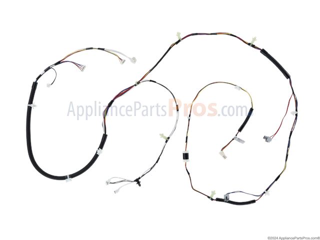

F4E1 is a heater relay/feedback signal error. That’s going to be either the heater assembly and the sensor on it W11549460, the main control board W11583890, or the wiring on the lower harness W11557918 between them.
