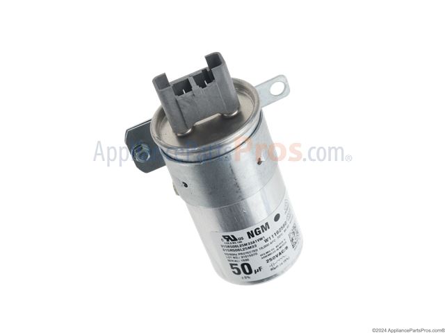

Ok, if the motor is moving the tub about a 1/4 turn and the same thing happens in Clean Washer cycle, you are probably looking at an issue with the lower harness W11643701 and/or the shift actuator W11481722. What happens is the control board can’t see the tub moving because of the lower harness or the tachometer built into the shift actuator, so it senses and then shuts down.
It is usually recommended to replace both of those together when this happens.
If the tub is just barely moving it might be the capacitor W11395618, so double check if the tub is moving pretty strongly about 1/4 turn when it senses.
