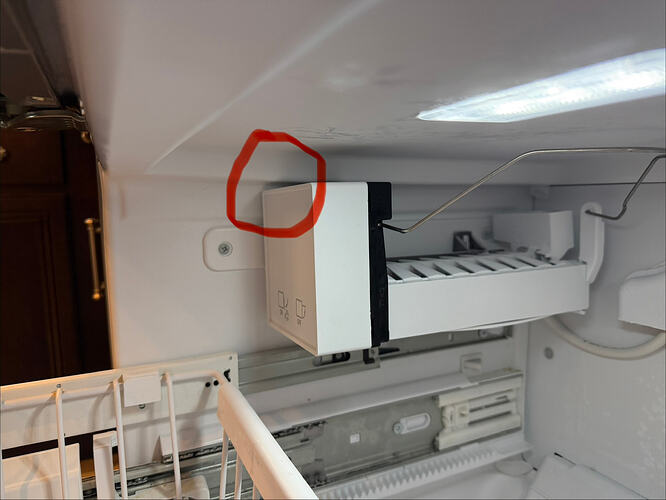

How to replace the ice maker in bottom freezer
Brand:Electrolux
Model Number:EI23BC82SS2
Main Symptom:Replace ice maker
What happens & when:No videos that I can find shows how to replace the ice maker in my specific refrigerator with bottom freezer. It’s not as easy as the top-mount videos show.
Error Code (if any):N/A

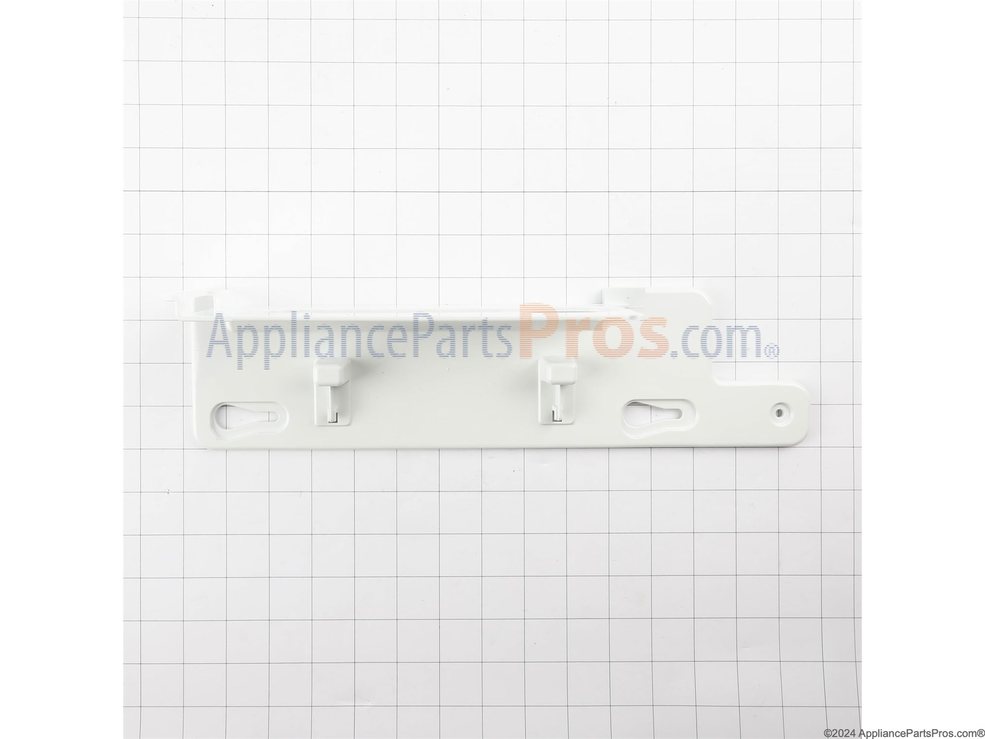

Parts or tests already tried:I bought the new ice maker from APP. I attempted to lift it off of the “hooks”, but the ledge above the ice maker does not allow this. Is there another way of removing the ice maker other than removing the screws that hold the horizontal bar that contains the hooks?
From looking at the bracket you should be able to remove that front screw and then pull the bracket and icemaker forward then to the right to take the whole thing off the wall. Our site has it upside down for some reason, but here’s the pic.
