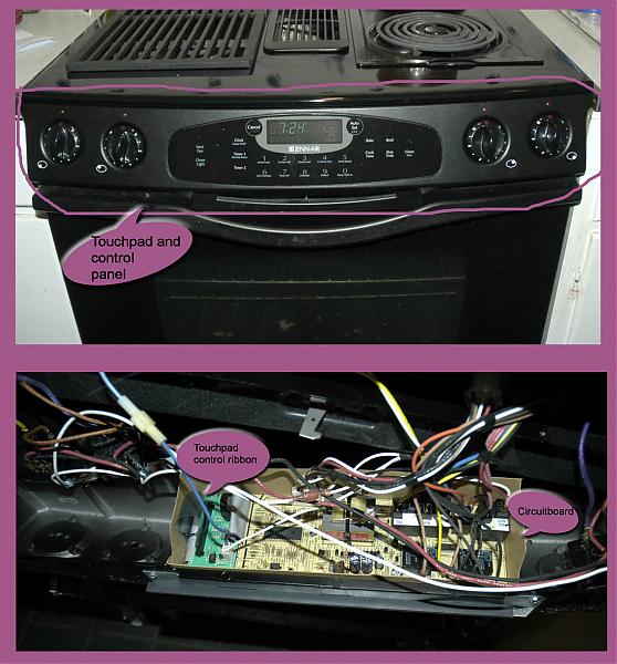

Jenn-Air JES9750 Electric grill/range - Touchpad control replacement part# [FONT=‘Arial’,‘sans-serif’]AP4094903[/FONT]
Two of the touchpad buttons stopped working so I wasn’t able to turn the oven or broiler on/off. As all else was fine, and the range is only about 5 yrs old, I was pretty sure the touchpad had failed. It’s a DIY project, but be prepared for some tough disassembly and reassembly. The touchpad is part of the entire front panel that contains the heater control knobs and the little red on-buttons. The entire unit is made of cast iron and comes only with the touchpad, so you must take everything off the old panel and reattach it to the new one. The unit sells for $200-$300 online. I bought my unit from AppliancePartsPros.com. Their price was the lowest and their service was terrific. A local repair shop quoted me $500 to do what cost me about $210 (and a little sweat.)
Here’s what I did to complete the repair. I hope this will be helpful to any of you planning to do the same.
Disassemble and remove the old panel –

· Behind the control panel are small white light boxes (about 1”x1/2”x1/2”) attached to the red plastic on-buttons for each of the 4 knobs. Gently slide each white box sideways to separate the box from the red light posts behind the control panel.
· Now, the only thing keeping you from removing the panel are the million wires plugged into the circuit board behind the panel’s touch pad.
· Before you remove the wires, take several color photos of the ‘rats nest’ and print them. Make sure you can see where every wire goes. Once you’ve mapped this out, you’re ready for the final disassembly.
· Pull the wires and wire harnesses off the circuit board.
o Wiggle the wire harnesses (about 4 of these) gently and pry them off.
o The touchpad wire ribbon is a thin plastic film with about 12 metal leads embedded in it. Observe which direction the ribbon is attached before removing it. To remove it, bend the clip (like a small bar) on the black plastic socket away from the ribbon. This will unplug 2 small pins that hold the ribbon in place. Pull the ribbon up out of the socket.

· Gently push the new touchpad wire ribbon into the black socket on the circuit board until it is firmly seated and snap the retaining bar with the 2 pins into the ribbon.
· Screw the circuit board onto the panel, attaching the insulator liner before screwing the panel in.
· Reattach all the wires and wire harnesses to the circuit board. Here’s where your photos are a must. Most of the cables are color coded, so you can’t really screw things up, but there are 2 black wires that look alike. Be sure you push them onto their respective prongs.

So I ordered my part online and got a great price $185 plus $10 shipping. Printed out the step by step instructions and followed the script up until it came time to pull the wires. My wife was home so I was grandstanding on how I was going to accomplish this part swap out and gave her an overview. So she comes up with “Why don’t you just unscrew the 4 screws and lift the circuit board out?”
So that’s what I did. The board came out and I swapped out the bracket and 4 red lights on the control panel and screwed the circuit board back in. This whole thing turned out being ridiculously easy.
