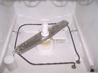

How do I remove the filter in a Jenn-Air DW441C119 Dishwasher ?
Is there a repair or service manual that can be downloaded somewhere?

What filter do you want to clean?
thanks denman for the link!

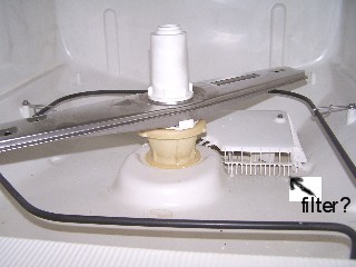

Basically, the water does not drain and stays, we suspect that there is a clogged filter(??)
Based on the schematics, where exactly is the filter?

I added a pic with an arrow pointing to where I am guessing the filter is located, what do u think?
Web dishwasher 2-arrow.jpg (18.7 KB)
Just undo the two bolts and it will come off.
Take note how the inside piece is installed. If you reinstall it incorrectly the chopper will eat it.
Be careful when looking in the sump as there is often broken glass in there.
If it is not draining at all make sure that the wash/drain solenoid (left hand side of the pump) is pulling down into the drain position.
Another common spot for drain plugs is where the drain hose attaches to the house plumbing.
