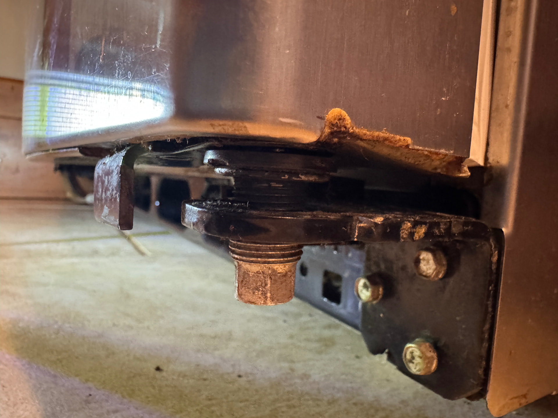

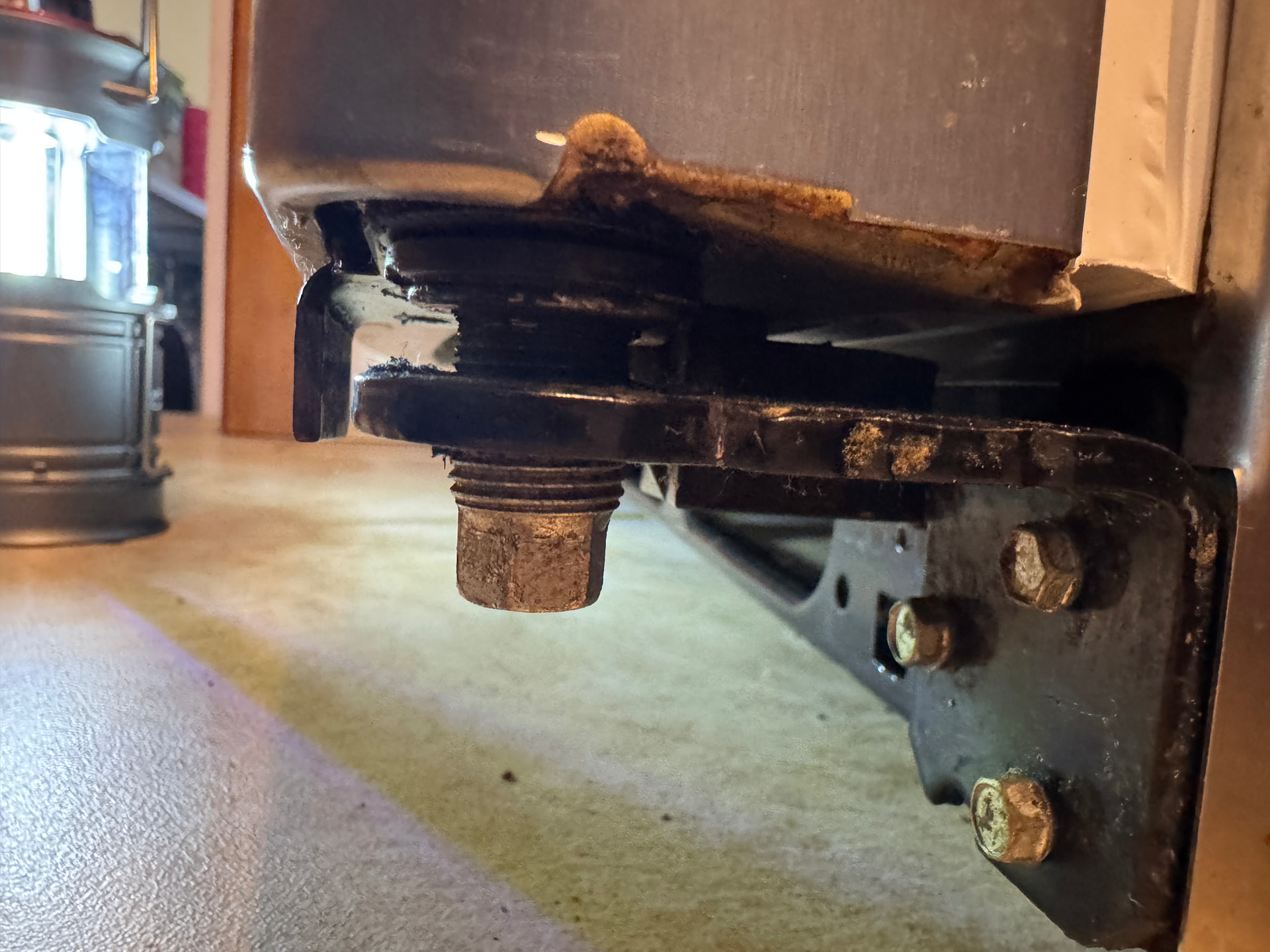

Brand:GE Profile
Model Number:PSW26PSWASS

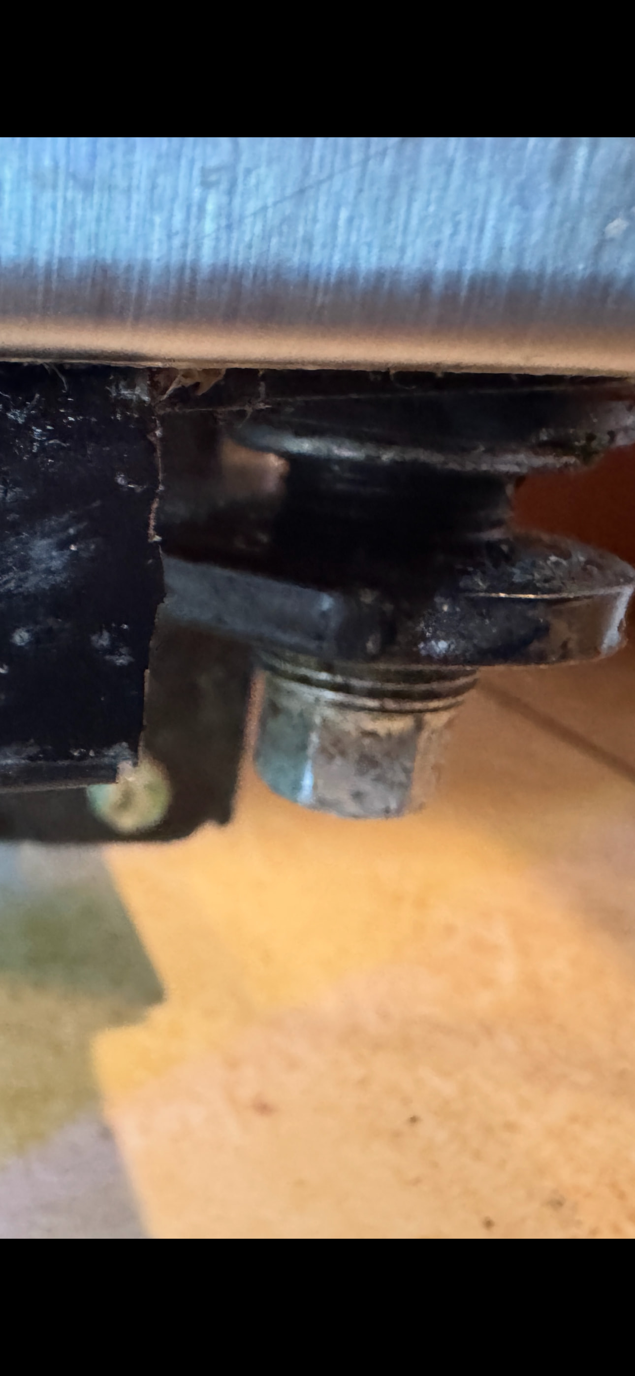

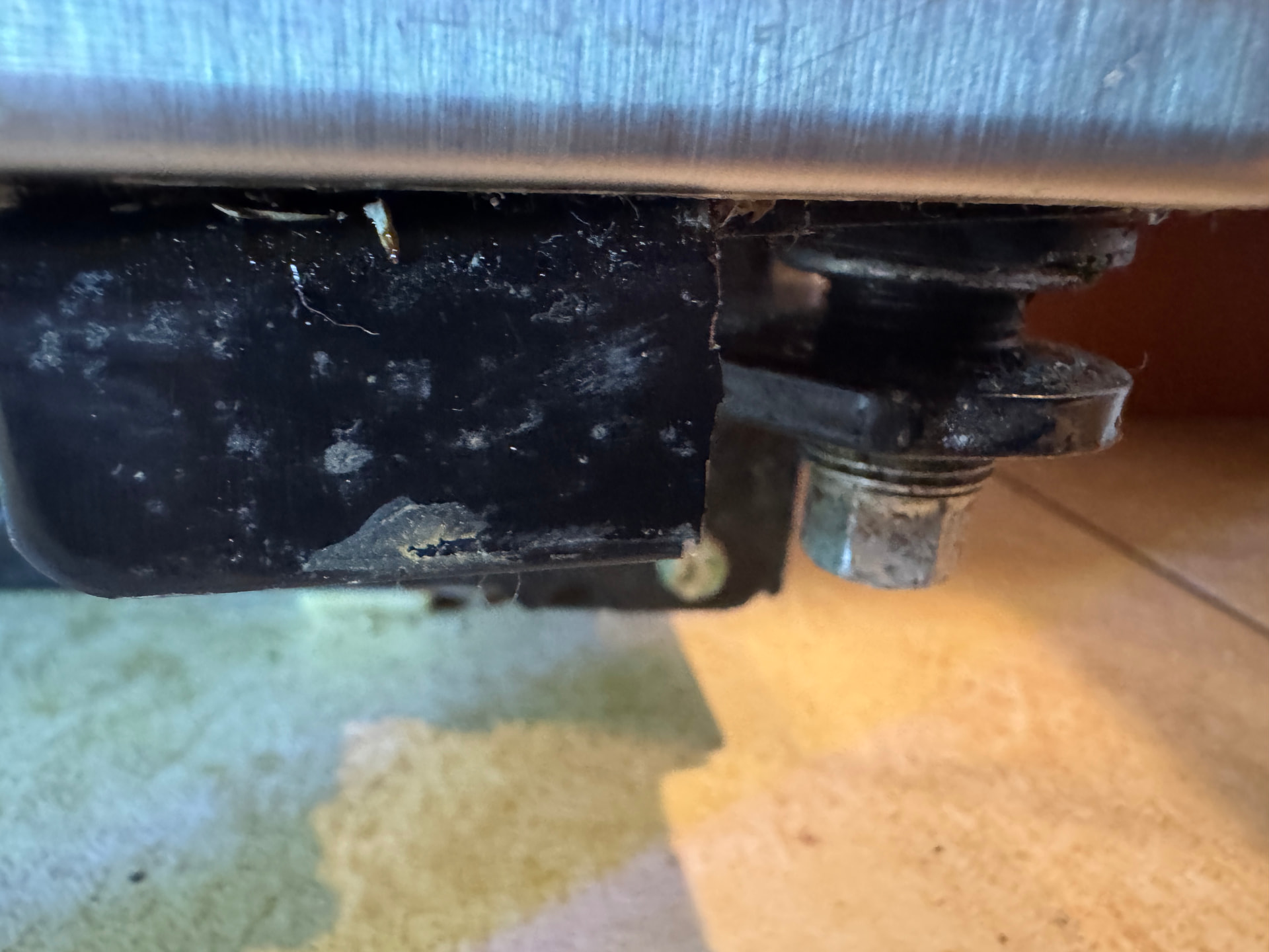

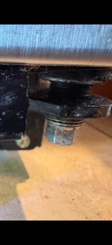

Main Symptom:Broken Door Stop
What happens & when:Door Opens to far and hits counter
Brand:GE Profile

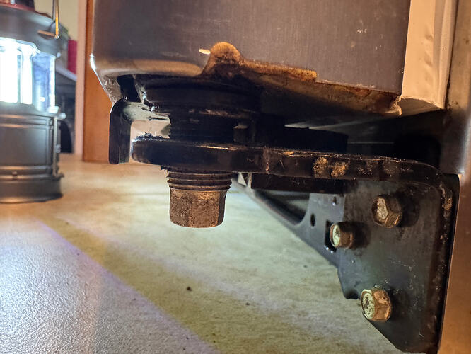

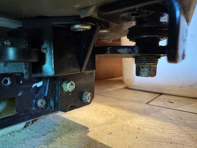

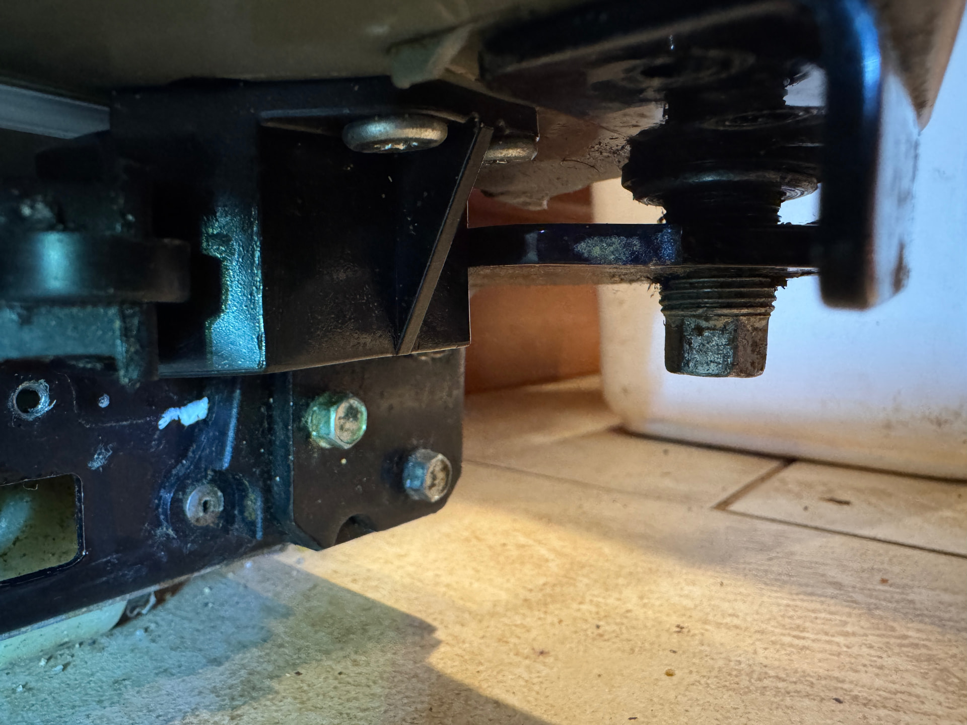

Here is a link to the door stop part number. To get this off to replace it, you will remove the top hinge and then lift the door off. Remove the old door stop and install the new one then reinstall the door.
https://www.appliancepartspros.com/ge-stop-door-wr02x12352-ap4300730.html
Please correct us if we are wrong. We have already ordered and received the correct part. My husband thinks that the bottom part of the door is screwed in and can’t just be lifted off. We see the nut for adjusting the height of the door to level it and that is where my husband thinks the door is connected somehow and can’t just be lifted. So are you saying it will simply lift off freely and without having to detach it from anything. Also we will need to remove top stainless steel cover to get to screws that remove the top latch? Thank you for your help!
