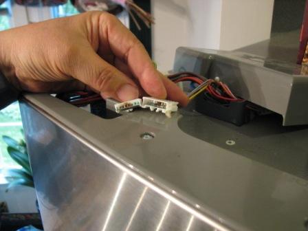

Hi Gene, first, I’ll quickly update you on the status. I purchased the display board, thinking that it is bad, from searsparts.com (ApplianceParts did not have it) and just had it delivered this evening. After replacing it, it still does not work. A couple of things were checked when the dispenser assembly was pulled off: 1) the display board itself and 2) 12V power at the board. I did think that the power board was bad initially, but, I decided that it was OK as the freezer/refrigerator is functioning fine. As well, I think there is 12V at the connector. Do you have any recommendation as to why the display board is not functioning? Do you think the other small board on the side of the dispenser unit bad? Is it as simple as replacing a fuse somewhere? I would appreciate any help and I thank you in advance.

Hi Gene, well, we are still at ground ZERO. The display is still out, but, the refrig and freezer is still working. I’ve went ahead and replaced the PCB assy sub (EBR60070707). That did NOT work. So, as you have suggested, I replaced the main PCB (EBR65002714). That did NOT work either. So far, I’ve replaced 3 boards: 1) display PCB assy (EBR65749301), 2) PCB assy sub board (EBR60070707), and 3) main PCB (EBR65002714).

Searching for some answers, I’ve looked again on replaced boards, etc. Then, I decided to check the connectivity again, since both the freezer and refrig were working. Surely, the problem was with the connection, specifically, the connector. It was burnt. With the replaced connectors, the display is up and working. All is well. Thanks.
Copy of IMG_1243.JPG (13.3 KB)
Copy of IMG_1245.JPG (18.0 KB)
