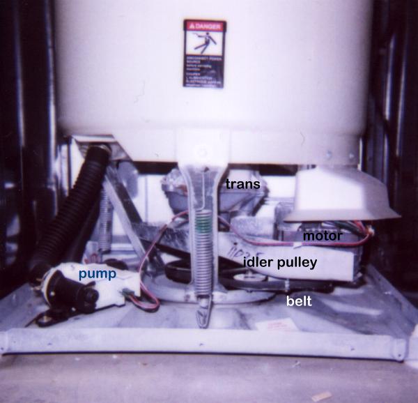

Does anyone have any idea how or where i can get directions on how to replace a belt on my washer
Here s a pic of it… Idler pulley goes to the inside pushing belt outward
I don’t get it. Does the belt just slide on when the idler pulley is pushed back?
Pretty much.. put on motor pulley then roll around large trans pulley… push idler in and put belt over it
Thanks! It worked and the washer is working fine.
