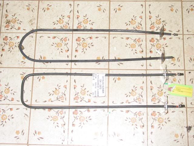

I received a replacement bake element today – took about a month from placing the order and never did receive confirmation it was still available, was just told it was back ordered. Here’s a photo:
According to the label it’s an Emerson CH-5870 and is made by Emerson Electric Co’s Wiegand Appliance Division. The label also specifies PCN 45866-0, I’m guessing an internal part number.
I installed it and it heats up fine, though I still have a problem, the temperature doesn’t appear to be regulating – just appears to turn on full voltage even at a setting of 100. Need to find out how the front panel thermostat control is supposed to work.
