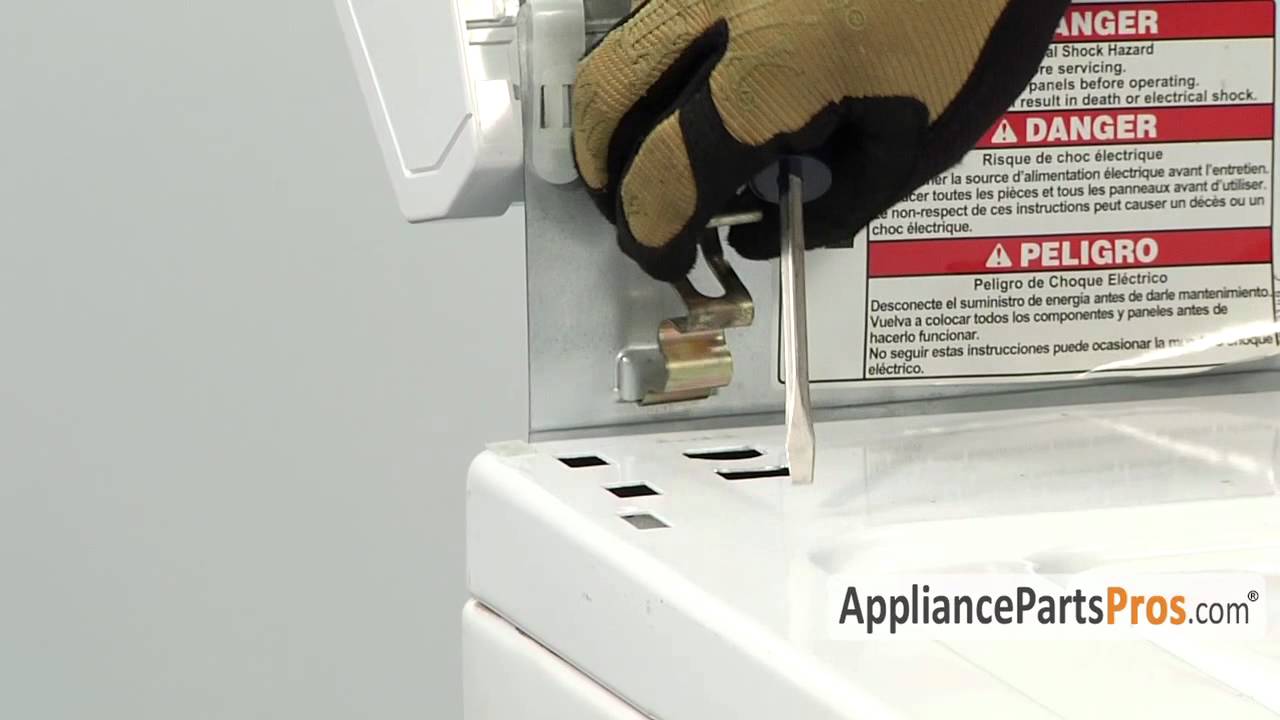

With the console out of the way, we have to go ahead and disconnect the lid switch and
remove the two retaining spring clips that hold the body to the frame.
With a flathead screwdriver, just pry them out.
