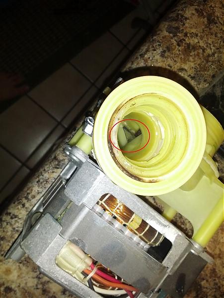

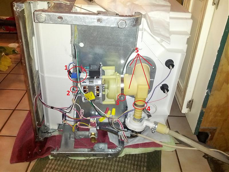

Just want to add to this thread as it help me fix my dishwasher tonight. To preface, I had a sound coming from the dishwasher like a garbage disposal. After reading this thread, I determined it was the grinder making the noise. I wasn’t sure if there was something in there that I could remove, or if the pump was bad and I had to replace it. Either way, you can follow the steps below to access and replace the pump.
So, I pulled the dishwasher out, and flipped it on it’s side, shown in the attached pic. The steps I used to fix the prob
  1. Turned off breaker!!!
  2. Removed racks from inside the dishwasher
  3. Pulled dishwasher out by unscrewing the two screws attaching it at the top
  4. Flipped dishwasher on it’s side
  5. Disconnected the power connection at #1 in the photo
  6. Loosened the screw at #2, but didn’t fully remove as it was holding the heavy pump up
  7. Loosened hose clamp at #3
  8. Removed screw at #2
  9. Pump will almost fall right off now, but may require a little wiggling
  10. After removing the pump, I found a piece of glass wedged under the grinder(shown in other picture)
  11. I shook the pump a round a little bit and the piece of glass fell out
  12. Then, I cleaned the rest of the debris around the grinder blade
  13. Then I figured while I had it open, I should clean out the other stuff by loosening the hose clamp at #4, and the four screws at #5 (glad I did because I found another piece of glass in there)
  14. Then I reversed the process to put it back together
Sounds great now and I hope this can help someone else.
