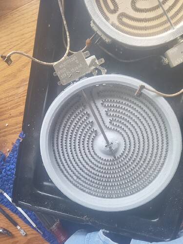

How do I connect W10823693
Brand:
Model Number:
Main Symptom:
I have attached the part instruction sheet for this part…see attached.
Mark the wires using the terminal identification numbers
before removing from the old element. The terminals on your
new heat element may not be in the same location as the
terminals on your old element. Marking the wires will make
it easier to connect wires to the new element.
3. Remove wires from the element and remove element from
cooktop.
