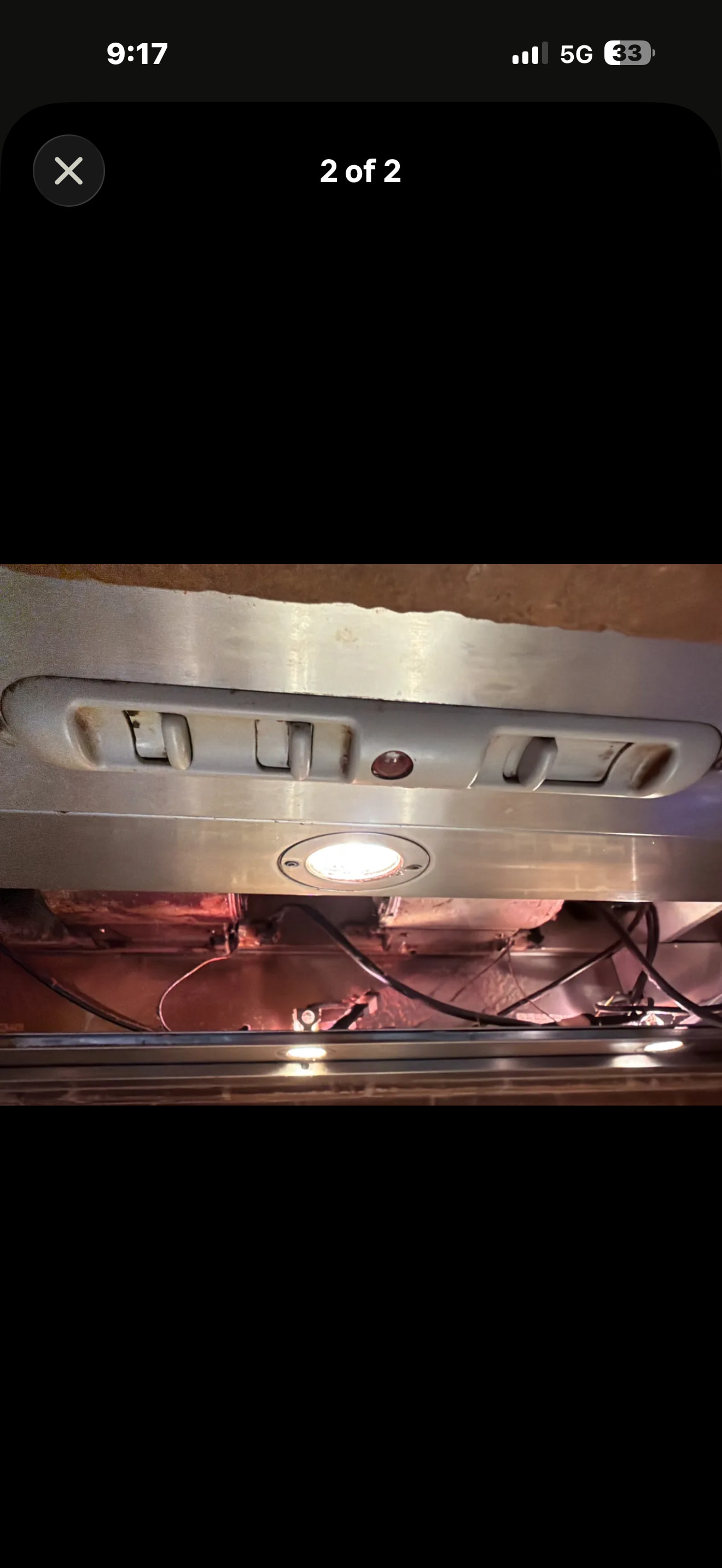

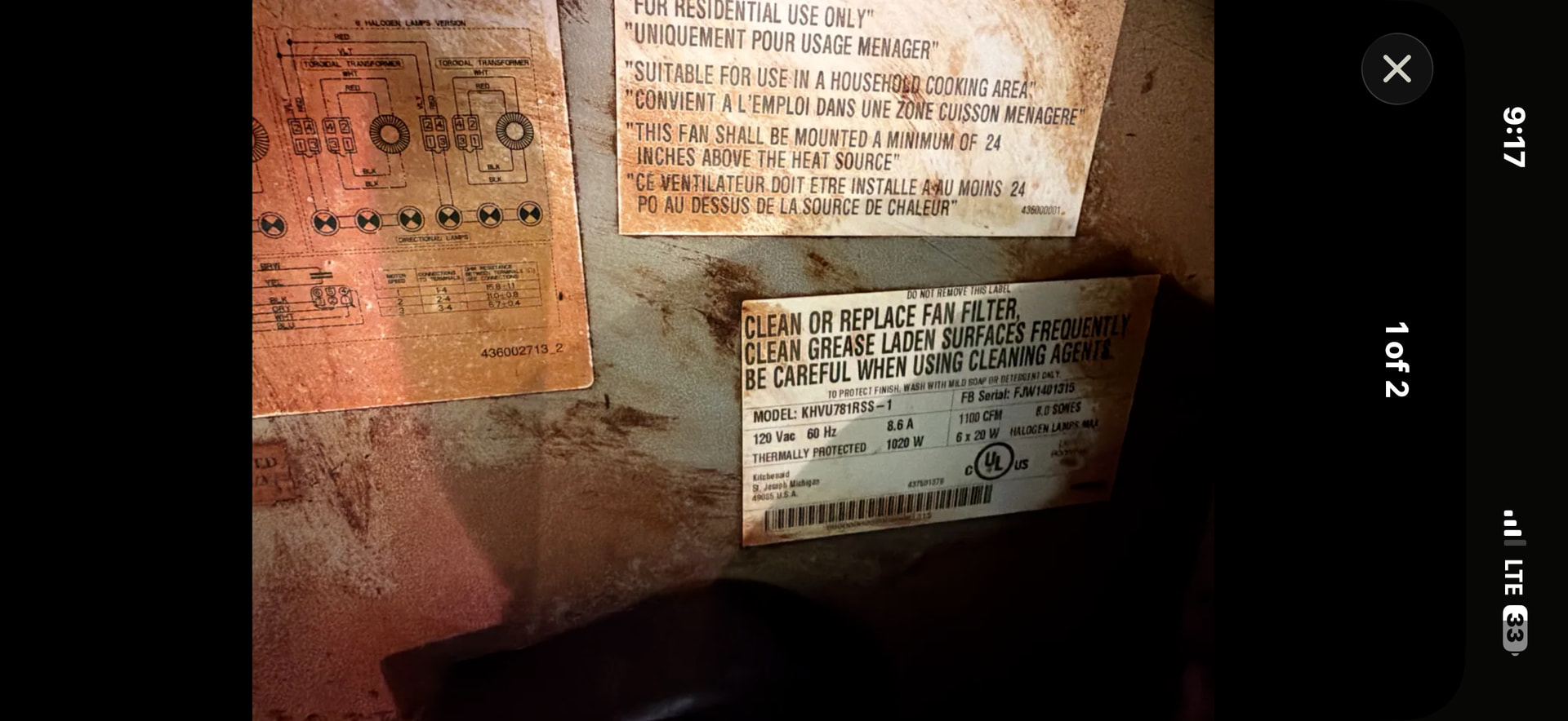

Hood power slider does not work anymore, need replace all 3
Brand: KITCHEN AID
Model Number: KHVU781RSS1 - Hood
Main Symptom: SLIDER POWER DOES NOT WORK, NEED SAME TYPE AND REPLACEMENT
Is it that the slide is not moving? If that is the case you may need to pull the assembly down and clean the area really good. If the slide will move but will not start the motor then the motor switch would be the most likely issue for this problem.
https://www.appliancepartspros.com/whirlpool-swtch-slide-wpw10252122-ap6017872.html
