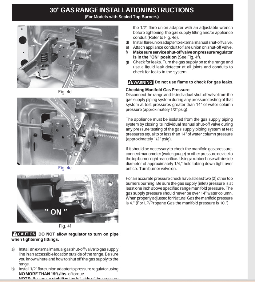

Okay, I just wanted to make sure so we could narrow it down. Since the appliance has never been converted between natural gas and LP, it sounds like the gas regulator may have failed.
A faulty regulator can cause an improper gas flow, which can lead to unusually high flames, yellow flames, or soot buildup. Based on what you’ve described, I’d recommend inspecting or replacing the regulator as the next step.
How do I inspect the gas regulator? What do I look for?
Do the stove top burners have a separate gas regulator? They seem to be operating properly when adjusting the flame from low to high.

I removed the bottom of the oven to see the oven burner when it is light. It does appear to be excessive pressure because the flame has a gap of about 1/4" before the gas lights. It also produces a slight whooshing sound. The top burners light and sound normal as expected. What next??
